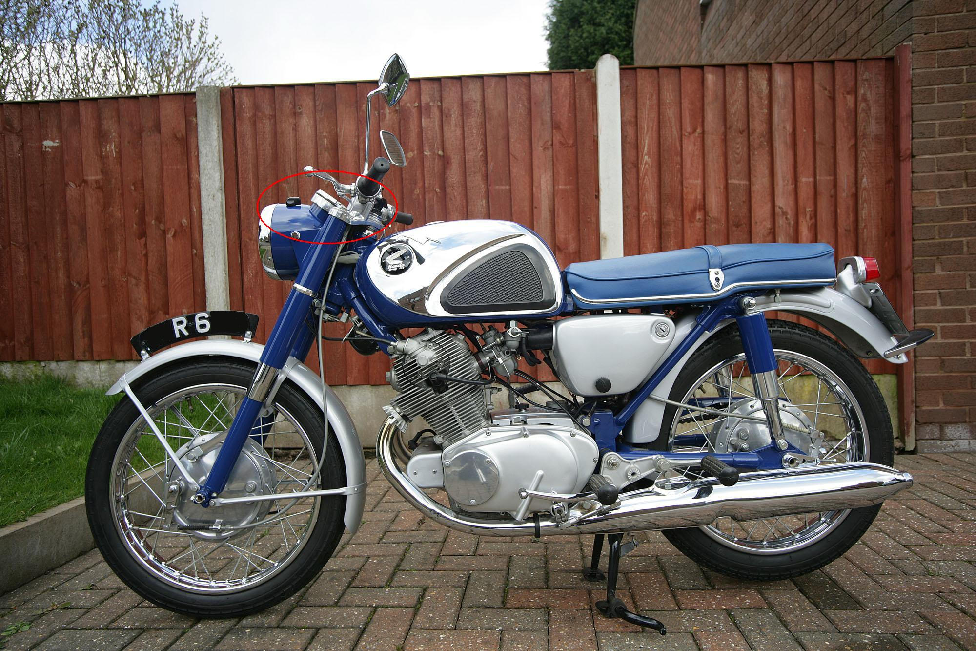

Ah, as per '61-issue, with the cluster ring in the upper steering yoke (triple-tree)? See pic.

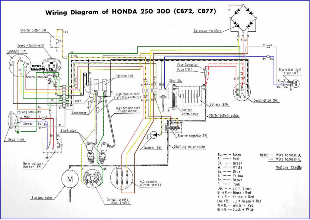

Wiring diagram in colour....
Post by e3steve » Sun Mar 08, 2009 5:34 pm
....as promised.

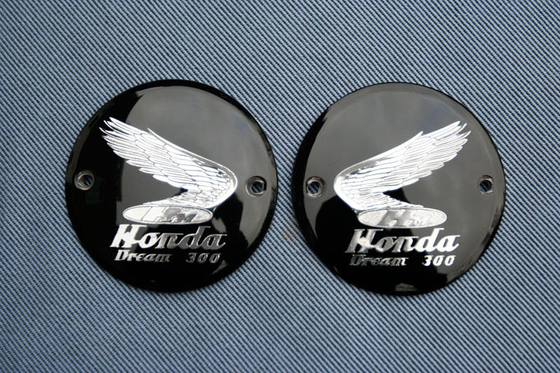

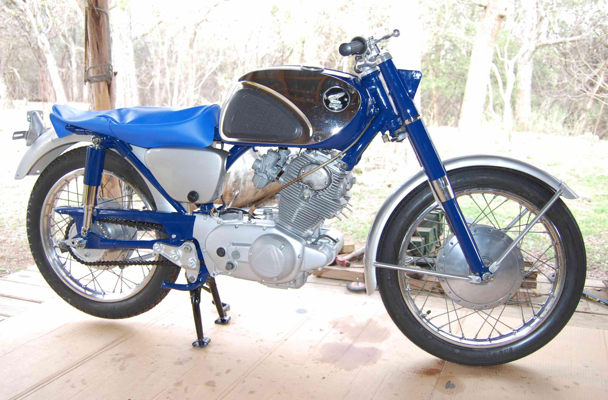

That's an awesomely perfectly beautiful bike. I particularly like the correct "Dream250" badges. They must be pretty rare. I'm jealous of the chrome brake and shifter linkages, I'm gonna have to do with paint for now. Not to mention the unmarred tank panels and mufflers. Or unrusty rims. I want some just like that!
Re glaring wiring error, that's in shop manual, not wiring diagram, right? Nice job on color coded diagram btw. Can you email me a jpeg or explain how to download from here as a jpeg rather than a web page (showing my ignorance again?)

I had a compulsion to hang tank, side cover, etc. on temporarily to admire how colors go together. Looks like I'll need more padding for the seat.

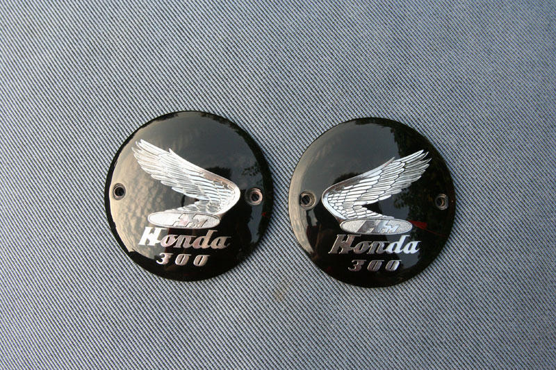

Martijn Elserman, in Holland, makes the badges: martijne@gmail.com ; see pics. Not cheap (€185, + secured delivery) but virtually imperceptible from OEMs. He'll inlay in gold (colour) at no extra cost, although special order only. I have the gold ones, and I have a l/h OEM http://www.honda305.com/forums/ads_sear ... me=e3steve ~ you'd struggle to tell them apart.
My 'glaring error' with the wiring diagram, surrounding the short, green wire to the lightswitch brown, is possibly in my own mind, but I shall clarify my findings. The over-drawn colour wiring diagram is much easier to follow; I wish I'd done it long before now. It took me no more than 90mins, whilst watching TV.
