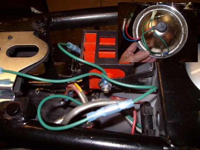

I finished the extra grounding. At the rectifier bracket I removed some paint for a grounding point. I put 3 wires from this point to connect the rectifier ground, tail light and headlight. At the headlight I connected it to the headlight ring so there is a direct connection to the spedo and headlight. I ran an extra wire along the wiring harness. With the old grounding strap in place from the coil to the motor case, and battery ground to the motor case, I think everything should have a solid ground.

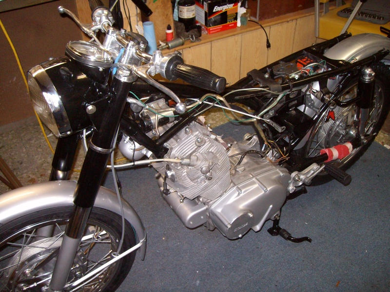

I finished up the headlight bucket. All the wiring is connected, and tac and spedo cables installed. The starter solenoid is in. The front brake and clutch cables are ran. It looks like someone had the brake lever in a vice at one time, so I polished out the gouges and both levers look like new.

I totally agree with your grounding method and rationale, Gunner; I did the same. I don't like relying on earth-return, preferring to to take a dedicated grounding cable to an established earthing point.

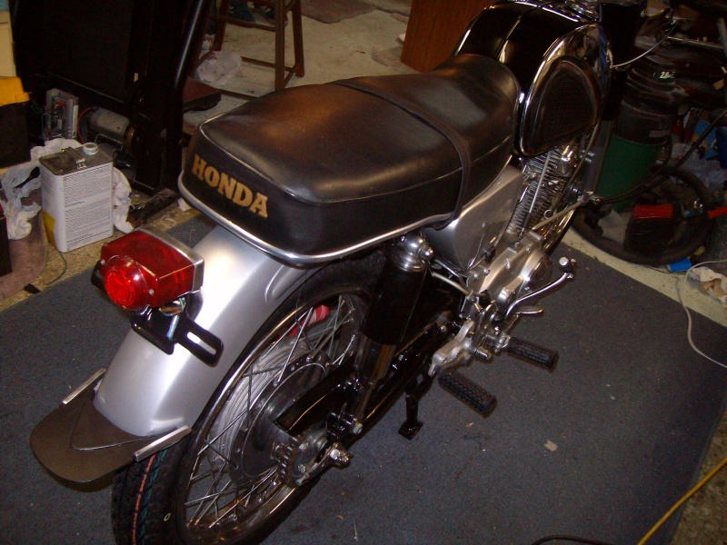

This week I finished up the wiring and tested it with the battery charger. Everything is working. Then we worked on the right side. We put on the chain, chain cover, clutch cable, and side cover. Next the linkage and pedals. Lee was right about putting the chain cover on first. The screw on the back is a bugger to get on with the wheel on.
Today we put the carbs on and the chrome on the tank. Retro bikes said they would have some rear brake cables in 3 to 4 weeks, so I wrapped the old one with some duct tape so it wouldn't scratch anything, and put it on until I can get a new one. We couldn't resist just dressing it up for a picture.
