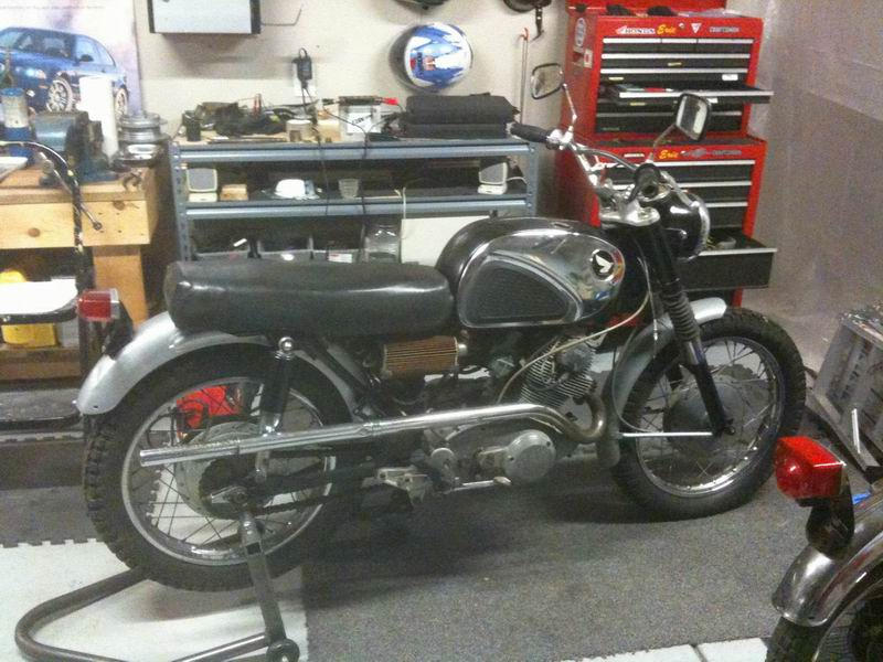

Here is my newly acquired 63 cb77 superhawk. The title shows 64 but the vin serial starts with a three. So I believe it to be a 63. Anyway, here is a pic. It's a rough, non-runner with rattle-can paint and aftermarket pipes.
I will cafe it with clip-ons, cr style or cafe style seat, stock headers and Dunstall megaphones, alloy rims, cb160 front fender and air filter pods.

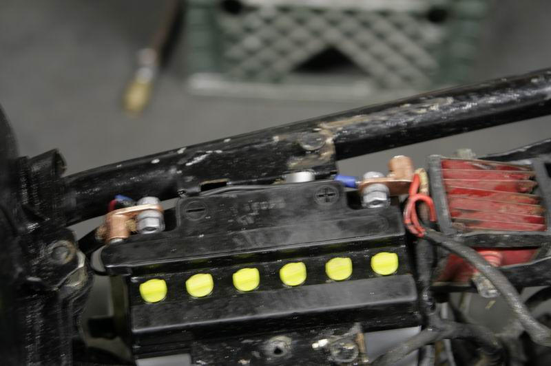

1. new battery and HD connectors

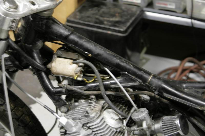

12. checked spark. one coil is different but works.

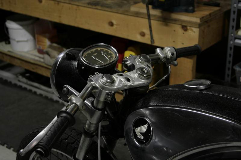

15. new adjustable clip-ons, 32mm.
16. aluminum headlight brackets.

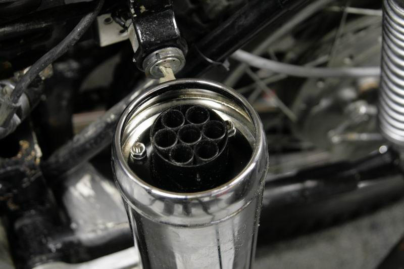

21. Dunstall mufflers.

20. cut handlebar clamps from top triple. still rough, needs to be grinded more & polished.

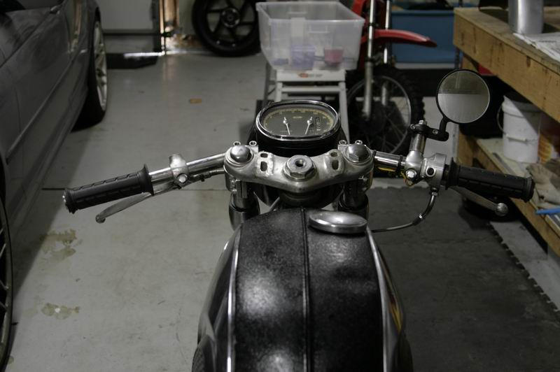

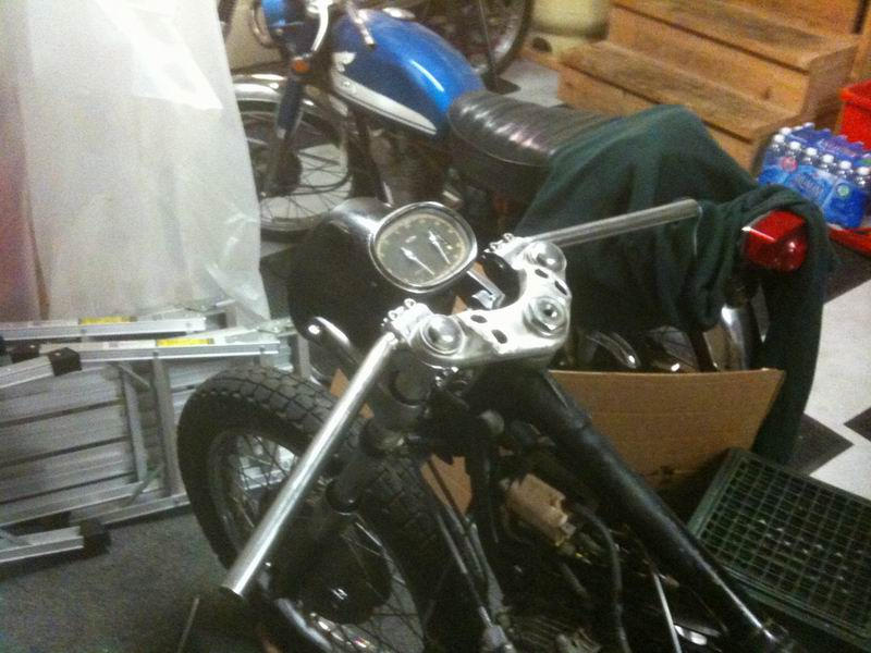

Here is the shot with clip-ons shortened and the bar-end mirror mounted on the top.

Curious to know why you've chosen clip-ons instead of the 'low' bars? As well, have you checked out the riding position you're going to have with these clip-ons? Are you also going to do something with your foot position? The reason I ask is that usually with clip-ons, you'd also have rearsets. Guess it all depends on what kind of riding you plan on doing (buzzing around town vs. long trips, for example).
The Dunstall pipes are really nice -- just keep an eye on that 'channel' piece that's on the backside of the muffler (where the hanger bar goes). I had three of them break on the face of that channel, so if there is a weak point about those Dunstalls, that would be it. Otherwise, they're very attractive, are 'period', and they're relatively inexpensive. Your headlight brackets are a nice touch too -- what are your plans for the fork tubes?
Interested to see how your bike turns out - thanks for posting this.
eyhonda
- Posts: 206
- Joined: Mon Mar 23, 2009 11:38 am
- Location: The Motor City
- Contact:
This bike will be just an occassional rider. I like the look and feel of clipons. I'm used to modern cbr bikes so it's ok for me. I wanted to build a bike that looks like a CR bike. The pegs are on the last position. For the forks, I will use the factory lowers or try to fit dust seals. Otherwise just keep it bare and open. For the moment, I'm just trying to get it started with no luck! But that problem is being recorded in a different thread ("will not start").
