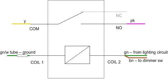

Hmmmm, I'd say so. 14.1 max, with a gel battery / 13.8 with a flooded lead-acid. And you're only sporting a tiddler of a battery on yours for voltage stabilisation. Look, wire in a small, single pole 5-Amp relay; it's switching AC, so 5A should suffice:
Contacts - pink & yellow
Coil - 1: ground, 2: coupled to the brown that feeds the dimmer switch centre contact
That way, when you switch on the lights the relay will pull in and link the pk & y to boost the charge. Let me know if you want a diagram posted.

Post by e3steve » Sun Sep 27, 2009 3:40 am
Deez, PM me your full postal address -- I'll send you a suitable relay & terminals. Radio Shack show an automotive relay with 30A contacts, but I'm guessing that your CR now has a small headlamp bucket, so space will be an issue.
Diagram shows a 'NC' contact, which I've greyed out; you won't need it, but it should be fitted with an insulated terminal.
Let me know if you need anything clarifying at all; I've kept it simple but, obviously, I don't know at what level your understanding of my terminology is.
I'm here for assistance.
