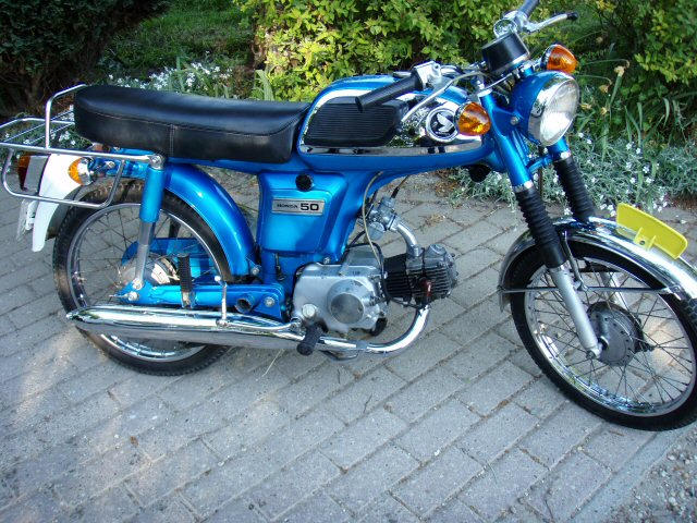

Well, it looks like I can finally post some pics! Yellow bike is a 68, the blue a 69. Can't wait to see yours completed!
