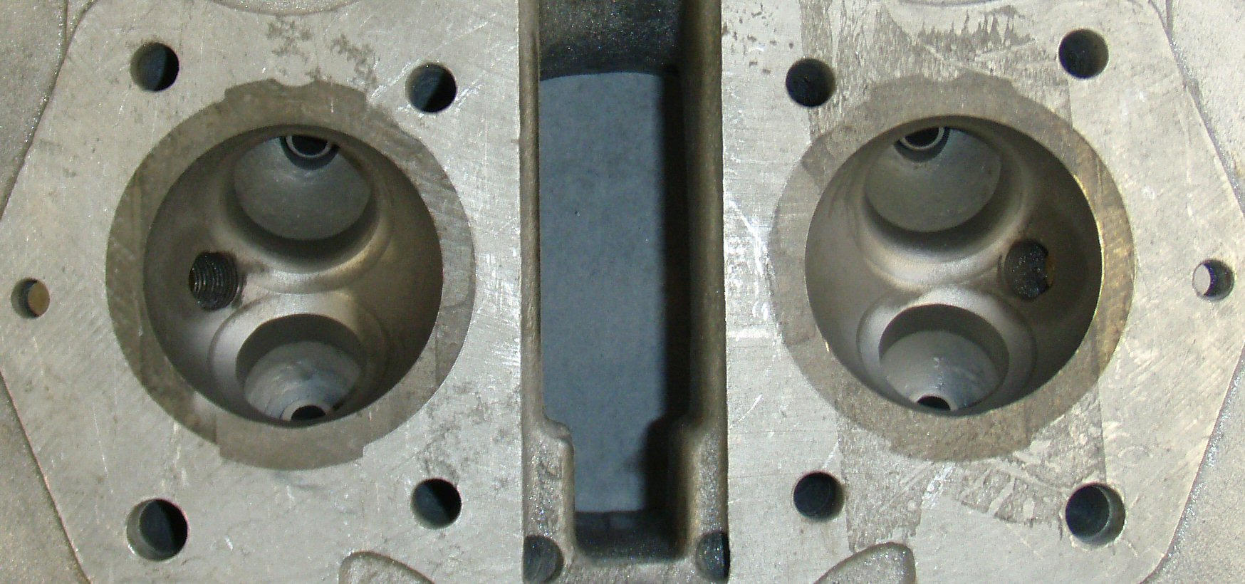

I’m starting this thread because I want (step by step) try to gain more power from a CB72 engine. I’ll give myself a year to get as much (but within reasonable limits) power out of a CB72, but not without making it unreliable.
Any ideas are welcome, tips, tricks, and storys.
A modern 250 cc twin engine delivers more than 30 HP, very reliable., and within noise limitations forced by low. I think I can get to 30 HP or more without increasing the volume.
I have a standard CB72 engine (late) as a basic start.
Since I don’t want to change it’s volume, I’m stuck to the standard bore. In this case power is gained mainly by the cilinder head, pistons, carbs and exhaust.

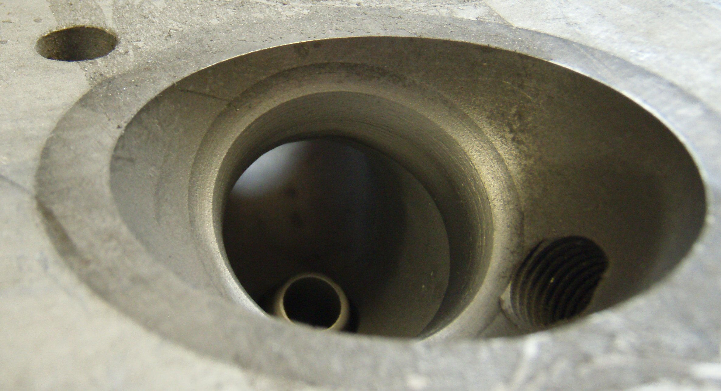

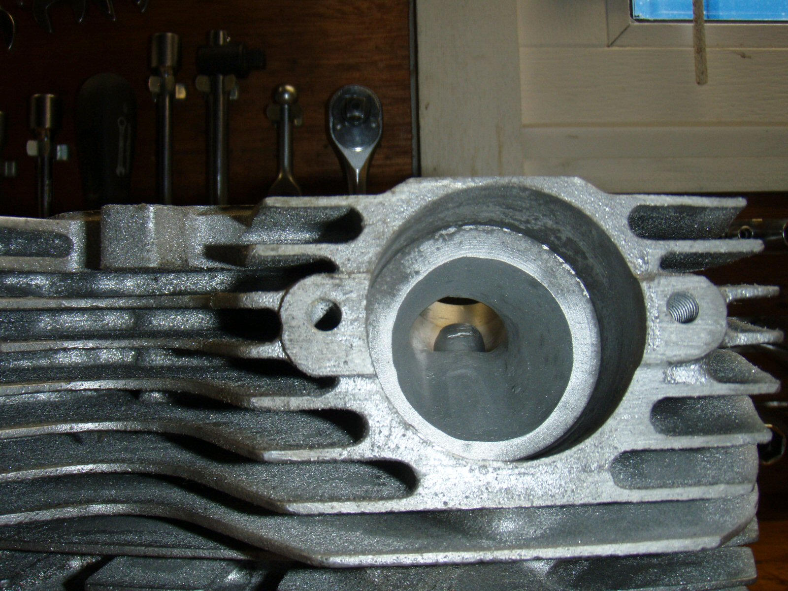

A few months back I bought a few cylinder heads for a CB72. I decided to take one (one with some fins broken off) and start to make the entrance aswell as the exit a little more up to it’s task.
Some people cut off (grain) the valve guide to clear the entrance and exit area, I decided not to because the live cycle time of the valve / valve guide will be shortened and that’s conflicting with the first sentence.
I also decided to use steel valves, Using titanium valves will shorten the live of the guides, because titanium does interact strongly with the material of the guide, in a negative way. The only way to avoid that is making guides from other material, and that’s going a little above my head and budget.
Valves out of stainless steel do have a shorter live time, are not lighter, so there's no real advantage’s.
I’m still struggling with the carbs, I can make a choice out of these :
Yamaha RD350 carbs (good standard choose, almost no atmospheric influences)
Kawasaki KR1-s karbs (these are flats-sides) (good for top speed, but atmospheric influences)
CB77 carbs (26 mm) (simple and easy to bolt on)
TZR 250 carbs (good carbs, I have gained a lot of experience with these)
CR carbs (exclusive, nice but a lot of atmospheric influences on the fuel / air ratio)
I decided to let the inlet 22 diameter, for as long I didn’t decided what carbs to use.
A few weeks ago I started with the head, pictures of what it became are displayed.
I doesn’t seem to be a lot of work, but in this head are more then 4 ours of graining and measuring.
Please compare with a standard head, and see the differences.
30 HP out of an CB72 ?
