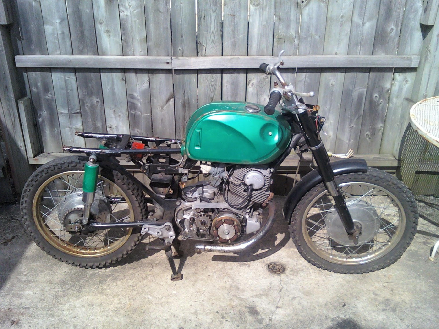

most recent pic...
since then i've:
cleaned the original DID's, it's amazing how well they cleaned up with a scotchbrite pad and wire wheel, far from perfect but very acceptable for a rider.
figured out that the chopped front fender was an original. ground and punched out the drive rivets to scavenge the bracket and will reinstall on the other fender.
bought a set of original mufflers in really good shape for $10! ordered some muffler rubber packing gaskets and will reinstall after cleaning up some original headers.
stripped the toolbox, air filter covers, headlight shell. still have to strip the tank and fork covers. removing the rear shock covers is the hardest part of working on these bikes for me.
the handlebar pictured is temp to be able to move the bike around. will be reinstalling the original mid-height bar after i finish polishing up the clutch/f brake lever perches.
bought an agm battery from a local company (will post more info in the product review section). the dimensions are spot on but the terminals are reversed...works out since i snapped the lug off my existing chassis ground cable, will install a new one on the right side of the frame. test fitted it and looks like the pos cables from the starter solenoid and rectifier will reach the post.
i have to say that it's extremely pleasing to work on these bikes. simple, intuitive, well engineering, small/light enough to work on without assistance.

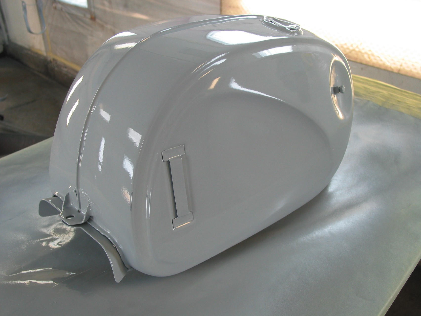

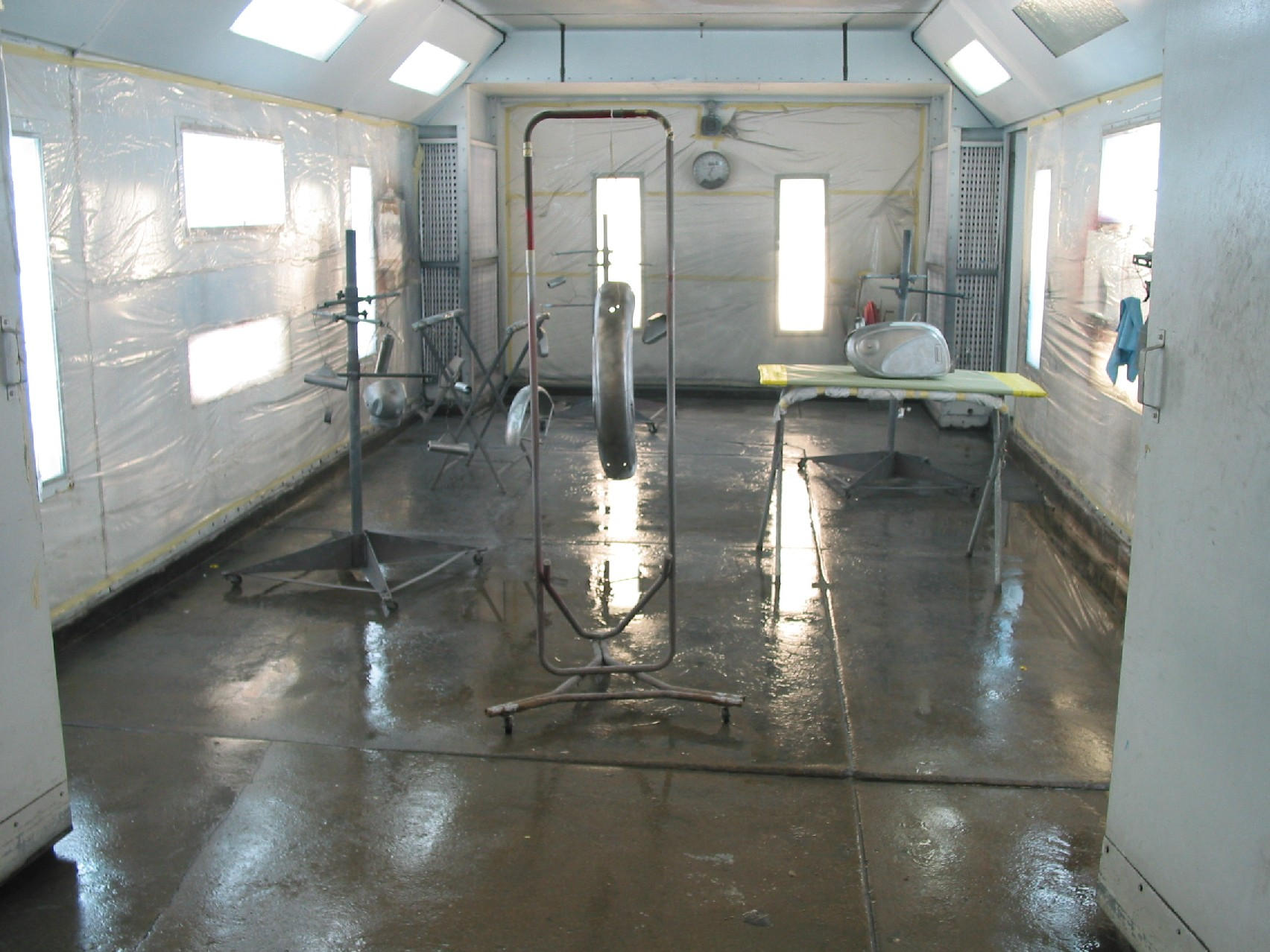

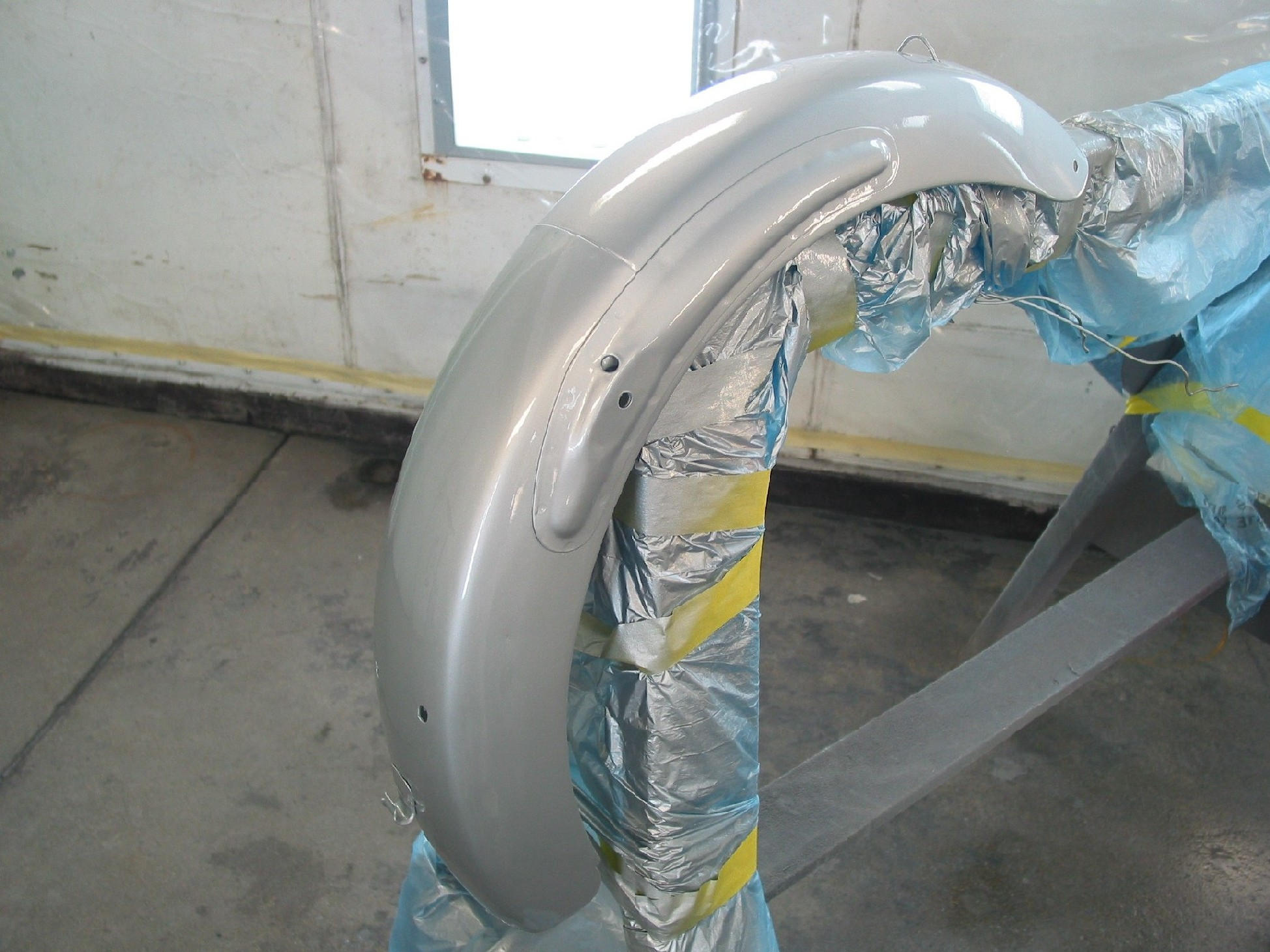

spent this morning finishing up prep work, loaded up the booth and shot everything with primer. the only parts that i am not refinishing are the frame, swingarm and front fork bottom cases. here's some teaser pics...
