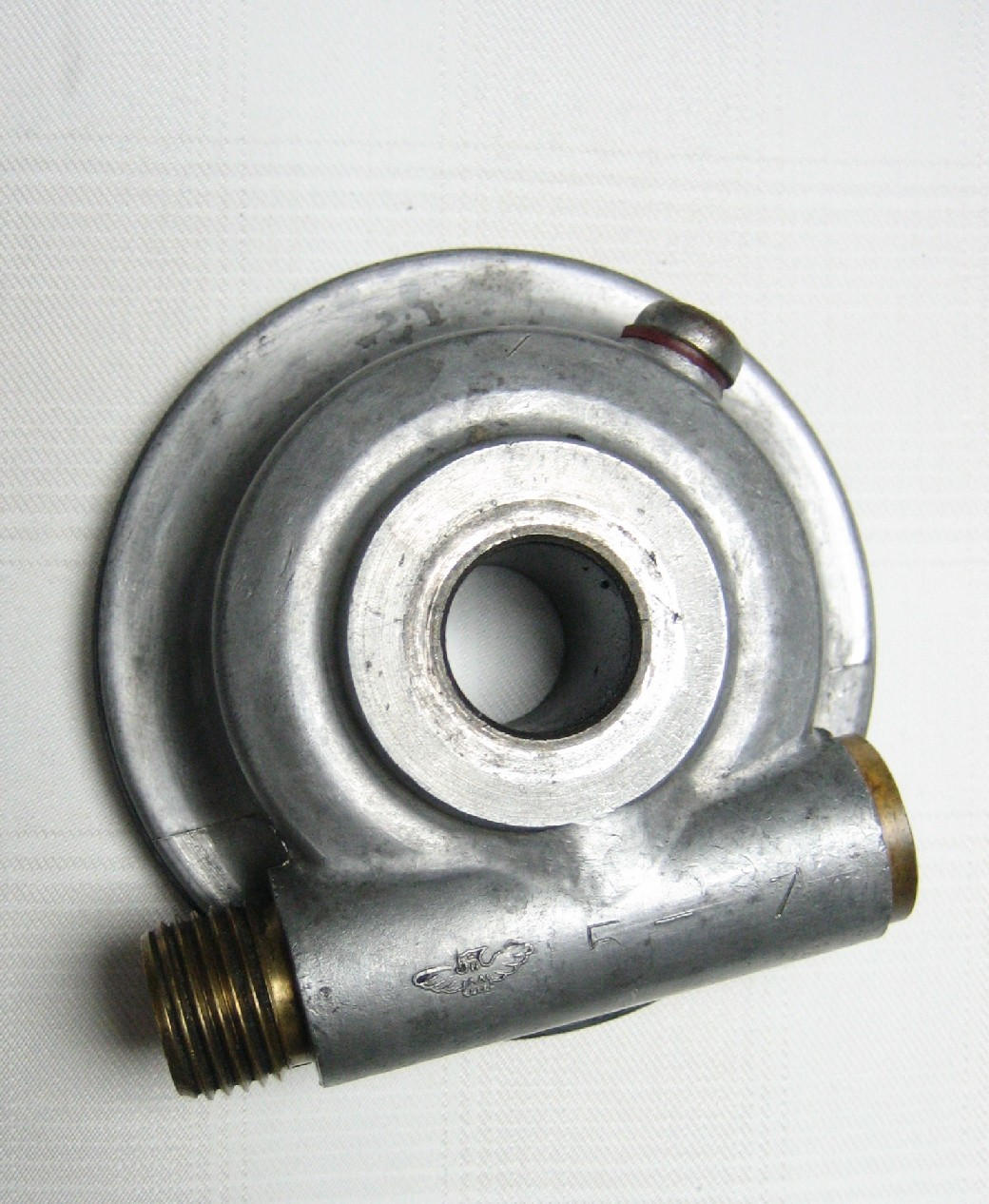

clean the speedometer gearbox (important note for future reference: came with this bike and assumed to be factory original, though the bike had no speedometer)
