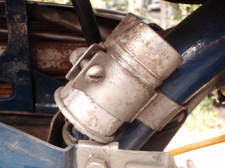

My guess is that the winker relay is mounted with the same bracket as on the CB72, on the main frame pipe, just between the air filters (the bolt is not original).
In the picture it is shown clearly how Honda attached the winker relay to the frame (1962 CB72)
Jensen

With help of others I found out that the winker relay for a CL72 / 77 is attached to the frame directly.
There is a clamp welded to the frame where the winker relay is bolted on. It is not the clamp that I showed in the previous mail. BTW, there are two types of clamps for the CB72 / CB77, one for the early bikes, and one for the later bikes. There are also two different winker relays, but both types relays have the same diameter, so these are interchangeable.
Jensen

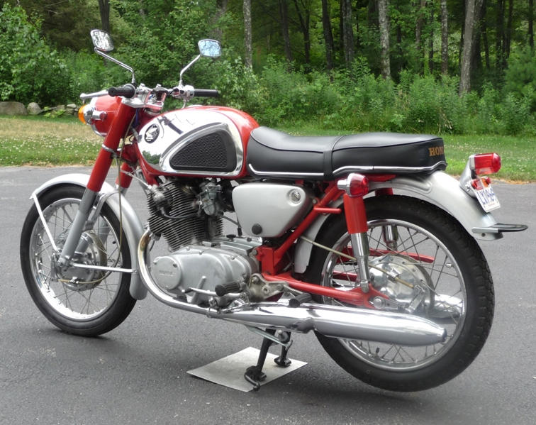

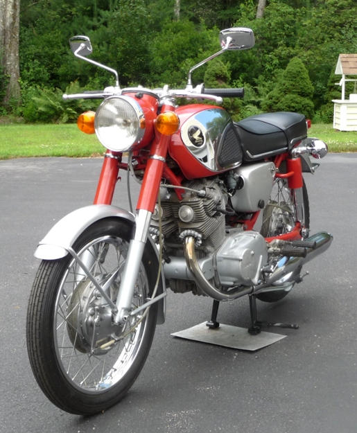

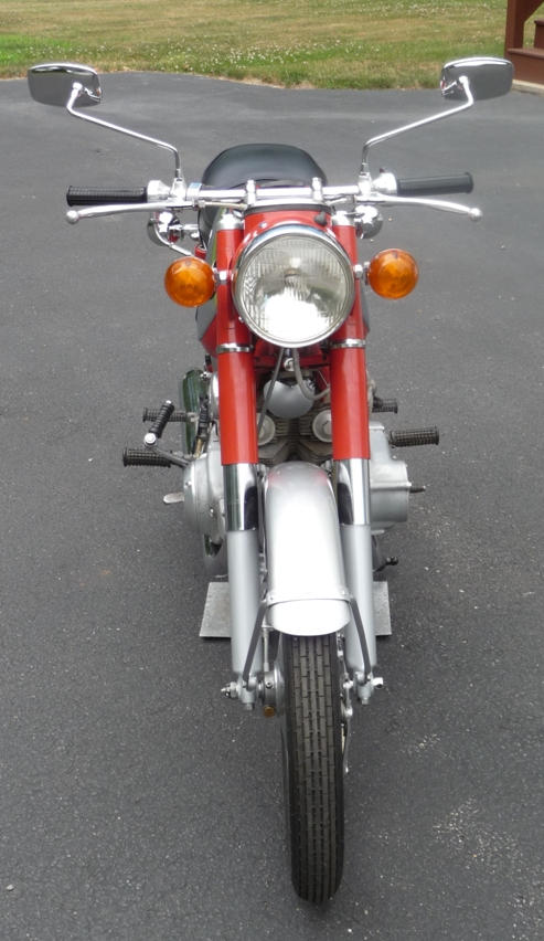

My turn Signal installation on my 1966 CB77
Post by phactory » Sun Aug 08, 2010 3:26 pm
I found a period aftermarket set of turn signals on ebay, for under $100.00 delivered. They were complete with four turn signals, two amber and two red. Four aluminum mounts, one switch, one flasher relay. Turn signals look exactly like Honda turn signals from the late 60's and early 70's, which I prefer.
I was lucky enough to find an NOS wiring harness that had the turn signal wiring in it already. I made most of the connections inside the headlight bucket, and that is also where the flasher unit it. I had to change the location of one of the wires on the ignition switch to send a switched 12V into the headlight bucket and that was it! I replaced the front headlight bolts with the mounts that came with the turn signals and used the rear mounts which I mounted off of the top rear shock bolts.
A pretty clean installation if I do say so myself! Plus it can all be removed in about 15 minutes, and no one will be the wiser!!
Phil
