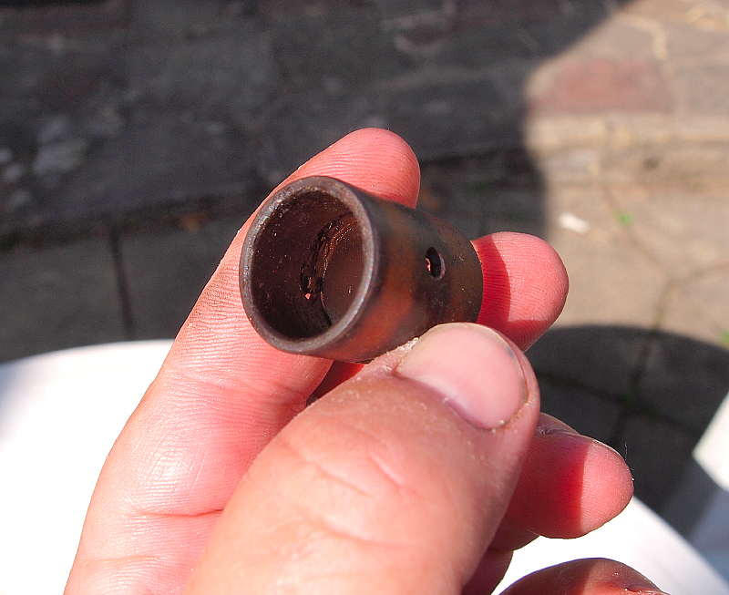

I took a look at my suspension link this morning and those bushes are what we Brits would call Tufnol. A paper or fabric reinforced resin used in lots of lightweight applications and electrical installations.

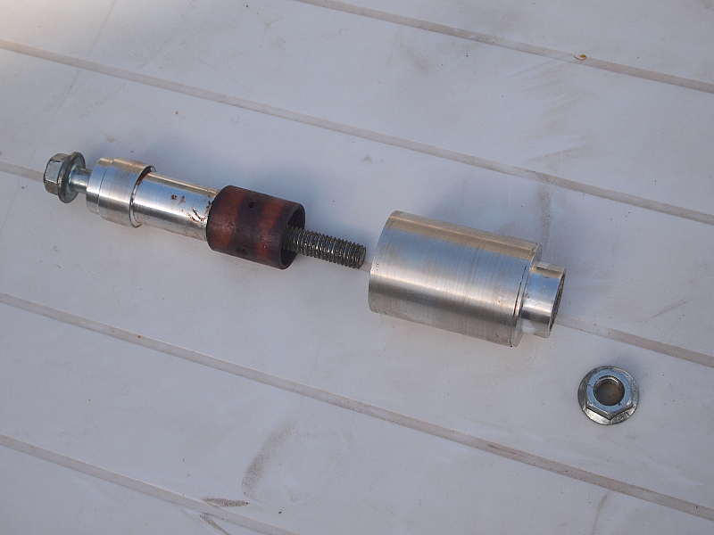

I made up the tool shown which fits snugly inside the bush. The outer hollow part locates in the groove surrounding the bush on the suspension arm. The bushes came out cleanly but I think that I will make bronze replacements for my two Dreams.
I have to dask off now but if you would like more pics or dimensions for your friend with the lathe, I'll send more details.

Tufnol front suspension bush from C72 Dream
Tool for removing suspension Dream bushes
