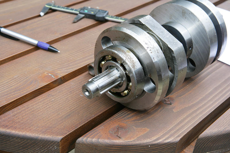

Post by Dennis Lodge » Thu Sep 23, 2010 9:57 am
Hi Jensen,
Further checking shows that one hole is within the hollow crank end which is blind the other hole being in the oil fed part.
Pictures attached.
cheers
Dennis

Post by jensen » Fri Sep 24, 2010 3:41 am
Hi Dennis,
In short, I never saw this before, and I checked my own cranks without any positive result.
Can you measure the crack bearing diameters (all four of them) and take a picture of the other side of the crank ?
I divided the following info in facts and possibility's (assumptions). Facts are real, and can be proved, possibility's however, should be proved, and as long there's no proof (both sides) it's called a theory.
Facts :
It seems to be an early CB72/ /77 crank (bearing rotor side), so p/n 13000-268 (275)-010. You also mentioned that there's no actual open connection between the two holes within the shaft, and that is weird indeed and doesn't make sense engineering wise.
Assumptions (but I rather call it possibility's or theory)
I am aware of the fact that the first crank that Honda shows in the part manuals is a 010 (for the CB72 as well as for the CB77), normally it starts with 000, so there could be another one, a predecessor, but not in the books, for unknown reasons. As I fully understand that the last three digits of a part number doesn't give any info on the part itself other then manufacturer or pointing out special parts or special treatment (racing, police, or destination / country), I still find it strange that it starts with 010.
I have an indirect proof of a possible existence of a different (000 ?) crank, and that is a (lower) crankcase of an early (no primary chain tensioner and sand casted surface) CB72 with a larger crank bearing diameter. I have never seen a complete crank with that larger diameter bearing.
It is a possibility that this crank has also the holes you show, but that is to be proven by the diameters of the bearings (still it is no proof for the existence of a 000 crank, but it is a proof of the fact that there are more crank types then the three Honda mentioned in the parts manuals,
It certainly has my attention,
Jensen

Post by Dennis Lodge » Fri Sep 24, 2010 6:08 am
Hi Jensen,
Find below pictures as requested with diamensions included. Also I managed to find my Nos 1961 crankshaft which is missing its outer bearings, all diamensions included. Certainly the balance holes in the CB72 I now see are smaller that the other crank.
regards
Dennis
