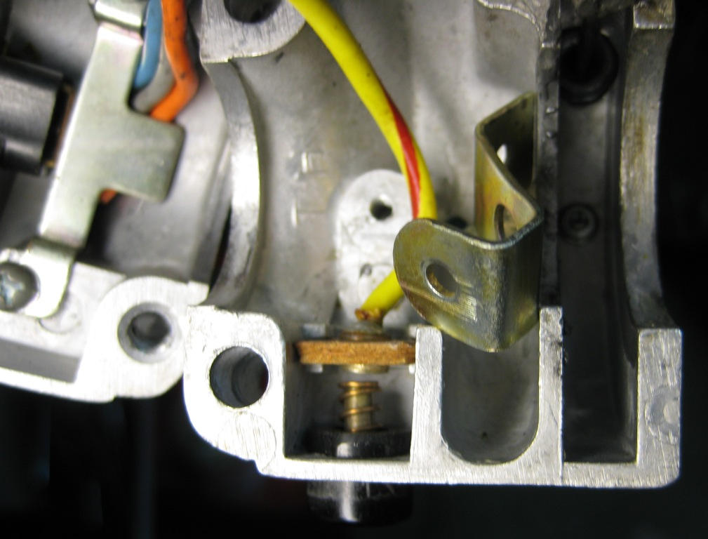

Post by e3steve » Wed Oct 13, 2010 6:42 am
Good one, Jeff. I must pull mine apart (it's NOS) and pic 'n' post it for future reference.
Thanks for updating.
Post by e3steve » Wed Oct 13, 2010 4:53 pm
Well, Jeff, this is how it should look inside the throttle cave ass'y. This is a CB/CP type but the internals should be pretty much the same. It looks to me like either yours has been 'modified' at sometime in its life (or mine is a newer, modified design). I see yours has the 2.5- or 3-mm screw thread in the base also, so perhaps the original retainer was lost and the plate was fabricated to take its place?. I can't get a good look at your retainer, but does it look 'home-made' to you? Perhaps the C/CA ass'y differed internally to allow for the throttle actuator.
Anyways, hope this helps clear up the anomaly.
