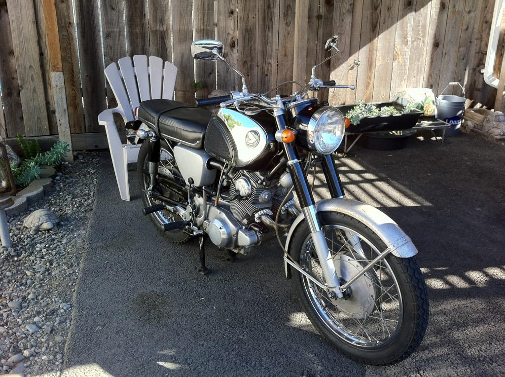

Thanks guys! I appreciate it and I did add a location to my profile. I brief history on myself:
I have owned a Jeep Wrangler and was considered a solid contributor to our forum. I enjoy working on things, and I love to help people as much as I can, with a humble attitude. I am really excited to join this site and for the restoration, piece by piece on my superhawk. You guys will probably get sick of me and all my questions but please be patient :). I am a slow learner but I have the willingness and wanting-ness to continue forward. I am extremely meticulous and find myself paying very close attention even to the small things. I am 22 years old. I am getting married in February. I look forward to being a help on this site, and being helped :).
Thanks again for all your help in advance!
Estevan
p.s.
here's my photo
[/img]
Estevan
p.s.
here's my photo
[/img]
Hi Estevan, Nice looking bike.
