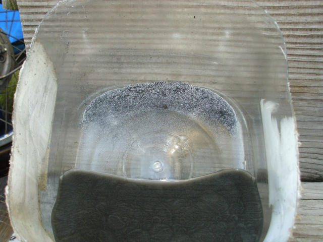

LOUD MOUSE wrote:With engine right side up ya will need to rotate the KS shaft clockwise and the pawl will no longer click. ..........lm
LM, Of course, the shaft itself rotates anticlockwise like any normal bike, therefore it must rotate clockwise to hit the stop. I was thinking of it from the other side and got all turned around. Good catch (as usual)
I figured. .........lm
teazer wrote:LOUD MOUSE wrote:With engine right side up ya will need to rotate the KS shaft clockwise and the pawl will no longer click. ..........lm
Thanks for the quick response guys, I had to write some reports for one of my customers so haven't been able to check it out till this morning.
I do have the right case off Teazer (good call) and when I rotated the K/S shaft clockwise (you're awesome Ed!) up to the stop the pawl disengaged and the ticking stopped.
This connects the dots for me with Ed's suggestion in one of my first posts that I move the K/S back on it's splines so it's not bottomed on the side case, now I get it!
Here's a little side benefit of removing the primary case, check out the aluminum mud that came out of the oil filter!
Something very dramatic happened to that engine in it's previous life and whoever repaired it didn't even clean the oil filter!
Re-enforces my "lesson learned" about not taking anything for granted on these things.
