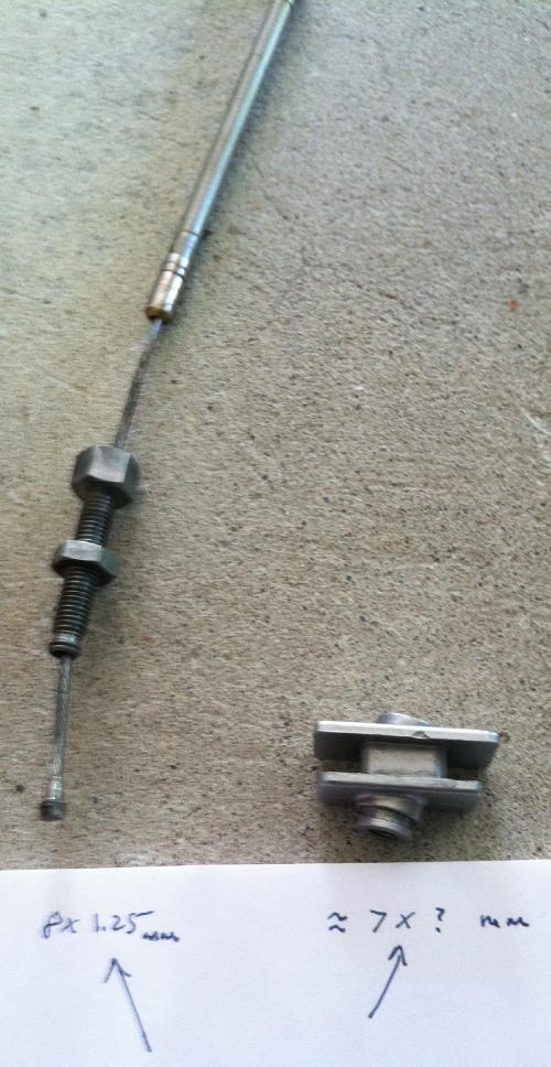

Hi gang. I'm about to install the clutch cable but the female threads in the "clutch cable joint" (the little piece that fits into the right case top) has a weird 7mm thread while the adjuster bolt (and lock nut) are 8x1.25mm.
I know I'm missing something, but I've run out of parts. Should I just re-tap it and call it a day?

ok, here's the pic. maybe this will help
The only thing I can think of is that this ain't a clutch cable and that it was with the bike just because. The cable has a metal mounting tab thingie (with an 8mm hole) which is not shown in the pic. The mounting tab is free to slide along the cable.

HA! I guessed correctly. The cable that came with the bike (the one in the pic) belongs to some other bike. I just got my new one from Retro in the mail, and it has the proper threads.
Silly me though ... I forgot to measure and I received the cable for low bars ... too short.
I just ordered the mid-rise bar cable from Western Hills.
