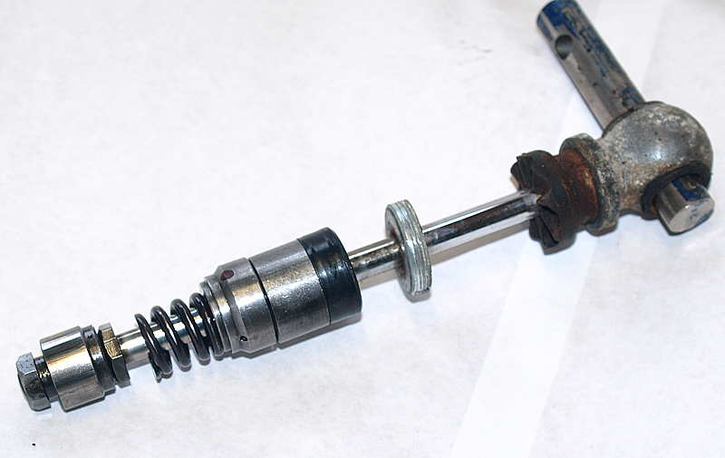

Hello. Does any one know if the damping case and plunger come apart ? I would like to re-plate the height adjusting ring but it doesn't fit over the mounting eye attached to the end of the plunger.
I have noticed that there are two small plug holes on the top of the damping case. Are the any thing to do with removal?

Yes you have to find / make a tool to undo that threaded ring, but beware as the shock casing will be peened over to prevent it coming undone.
I made a set of tools to dismantle mine which included a puller to withdraw the shock absorber internals.

The peening of the shock body goes into the slots in the threaded ring so it is a good idea to drill out the pips before you attempt to undo the ring. It's usually quite tight. I used a piece of 3mm flat bar, drilled a hole for the damper rod then bent the end at 90 degrees so that it would drop right into the slot.
The bush just below the ring and seal in my picture is very tight so you need something to pull it out if you're not going to have oil and bits flying everywhere.

Thanks G-Man. I have been making up tools in the workshop to strip the shocks. I'm a fabricator/welder so I have all the bits to hand, and if the boss is reading I did it during the dinner break!
