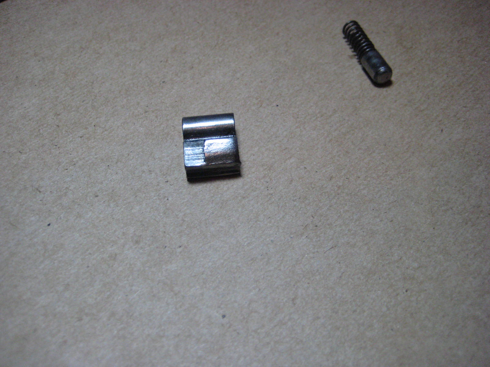

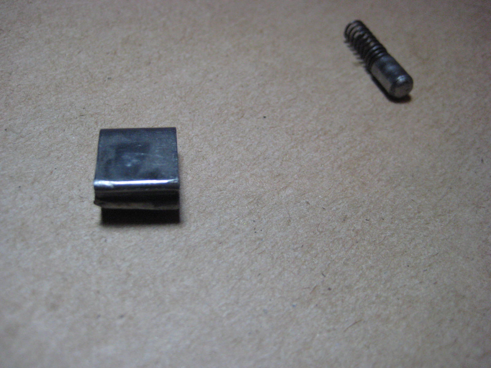

Anyways, These are not very good pictures ( I needs a better camera) but will post anyway of the spring, pin and pawl.

Definately show some wear. Personally I like to replace them unless they are in really good shape, as replacement requires splitting the cases. That said, I have torn down engines where the kicker worked fine, and the pawl was twice as worn as yours.
