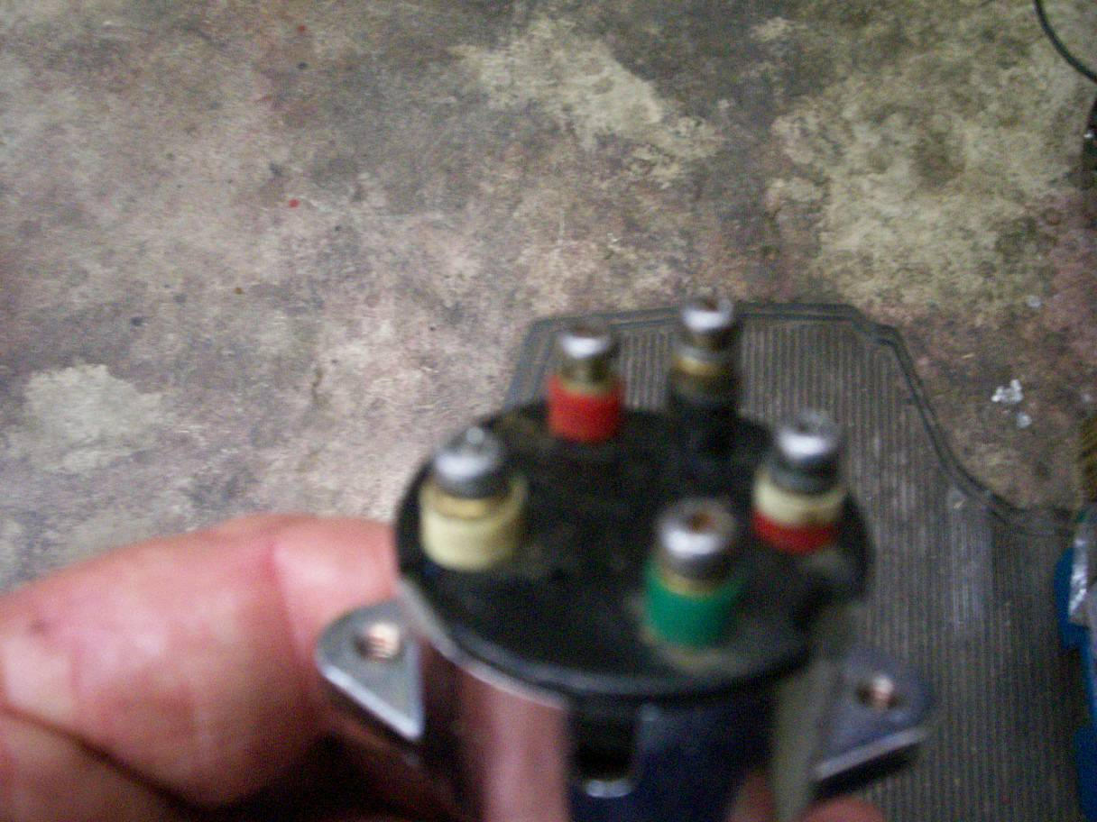

switch

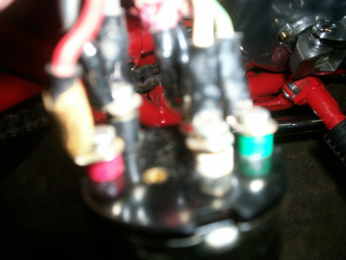

Post by rebelbob » Mon Sep 08, 2008 8:33 pm
3rd pic

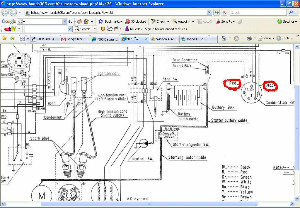

Ignore my PM about 'CB' or 'CL', Reb; I see it's a CL. Remind me, did this just 'happen' or had you been working on it?
It looks like there's a black wire missing that goes into the headlamp. I'm not too familiar with the CL, but I believe, from the wiring diagram, that there's a black wire from term IG to the coils and another to the lighting switch in the headlamp (on the CL also?).
But, you say, that just 'jumping' terminals BA & IG in the keyswitch gives you full-on functions, right?
Do you have a test meter or a test lamp? With a meter on 'continuity test' (beep or ohms range), disconnect the battery neg cable and dis both terminals BA & IG, then check for continuity between said terminals with the key 'ON'; you should get a beep on the meter or 0.0 ohms on resistance range (near as damn-it). If you have just a test lamp, leave the wiring in place, clip one end of the lamp to batt neg and check on terminal 'IG' for a light.
Get back here with results please.

Picture is blurry and hard to see wiring details. Ther should be two black wires on the same terminal. One comes from wiring harness A and the other from wiring harness B. If that all looks good, a clearer picture please.
