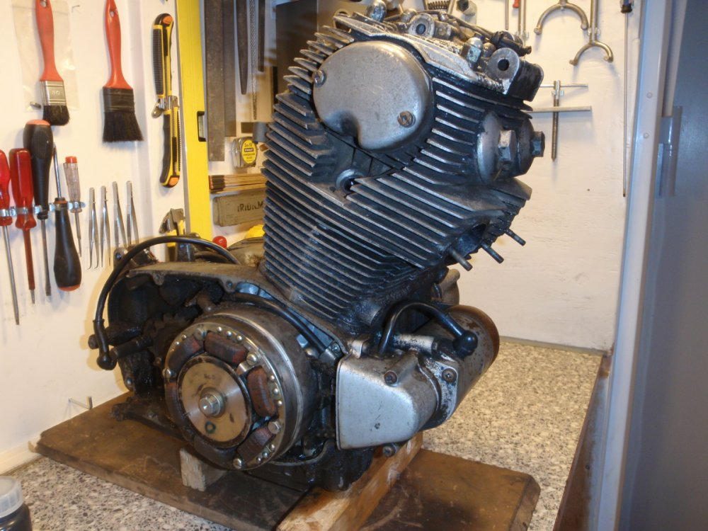

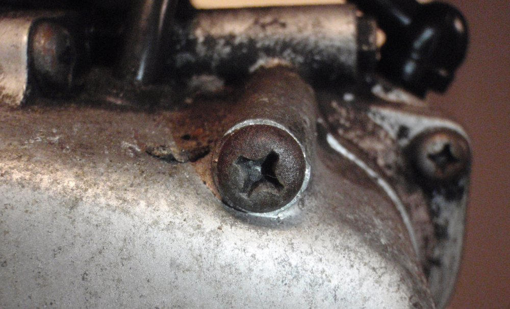

In the past there is a lot said and written about the Philips head screws Honda used in almost all there engines. Everyone who wrench on these bikes and engine know how hard it can be to get them unstuck in a decent and not frustrating way. Since a few years I have found the ultimate way to win almost every battle with these screws. In most cases I save the screws so I can re-use them, saves money and the bike and engine stays original.

So, how do I do it ??
I use a diamond tipped Philipshead screw driver from a good (German) brand, some force and sometimes a little penetrating oil.
I pictured the step by step process in this thread. So I suggest, buy a good screwdriver and try it at home !

I use a Tee handle screwdriver and always try to move the screws by tightening them a little first. This means that you have a fresh surface in the screwhead to undo it once you have it moving. Like you I try and support the engine and often put it on its side so that I can use my weight vertically.
On my 1962 Dream motor I soaked all my screws for about 6 months and got them all undone without damage. I do occasionally use an impact driver but it requires a good technique with a steady blow from a quite heavy hammer.
