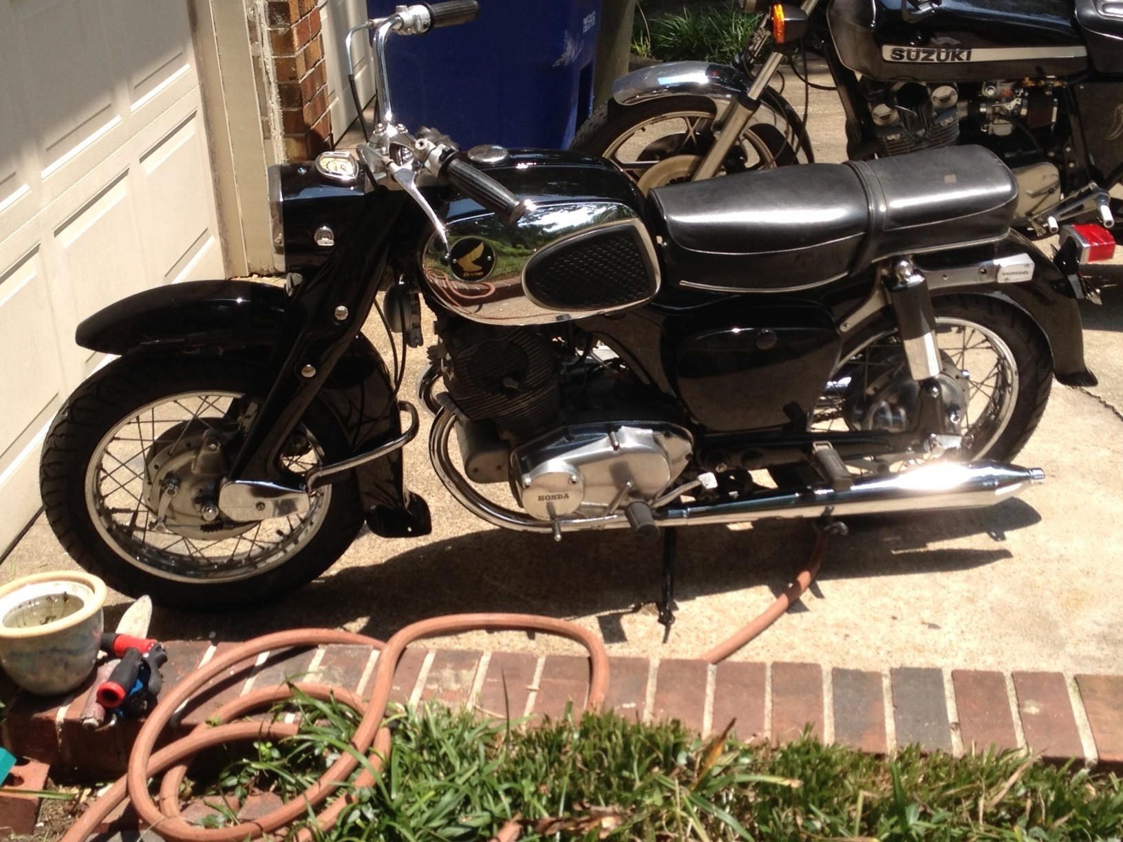

Hi folks,
Been banging away on my '63 Dream, finally getting the thing back into shape after it's long sleep (been off the road since '78). It's looking a lot better than when I got it (see pic), but I had posted earlier about a smoking cylinder and whether I should open the engine up and check the rings. I got mixed responses, some saying I should do it now, others saying that the smoking would likely go away after the motor was run in. Well it appears that the fix it now people were right, I decided to take my chances and install the engine back unopened following the restoration, and after a good bit of running it is still seriously burning oil. I have since dropped the engine and opened it up - clean with nothing remarkable (the bike has less than 10k showing), but both oil rings shattered when I tried to remove them. My question (finally) is should I lightly hone the cylinders before reassembling, or just put everything back together with the new rings?
While I have some limited attention, I have another question for Dream owners - I bought some new tires with a modern tread and profile, not vintage. I noticed during my limited driving that the bike really wanted to tip into any turn inputs that I made, something that made for some difficult to coordinate turning. Would this behavior be a result of the non-original tread and profile? the tires that I put on have a much more rounded profile that the period tires, I was told by a seller that these would make the bike a lot more stable at higher speeds than the original tires - but the bike is very squirrely steering at this point. Any insights?
Thanks for your help!
Jack
