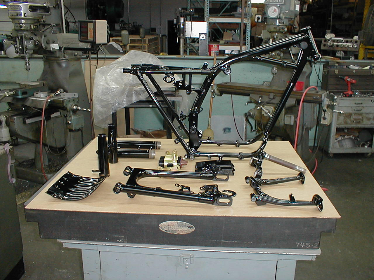

Finally got a chance to take some new pics of what I've had done to the scrambler in the recent weeks.
Included are pics of the frame and associated parts after powder coating along with the engine before and after blast cleaning.
More to follow......
Gary

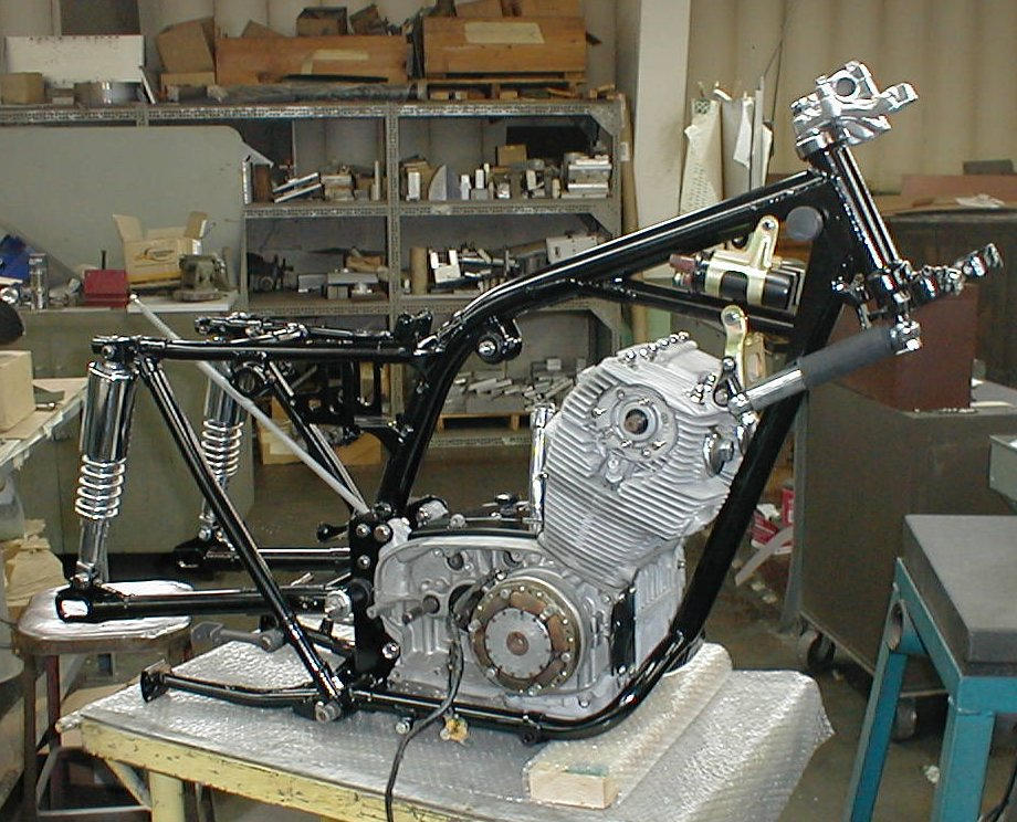

Well, it's taken a while but I finally have a couple of new photos of the bike.
After ordering and ordering and ordering plus half a dozen trips to the bolt store, I finally got the engine ready to drop back into the frame this week.
Stainless and chrome bolts have replaced all the original zinc plated hardware and several polished aluminum pieces later this is how it looks at this time.
Slower going than I had originally anticipated, It's finally coming together.
I now have to block it up higher to finish assembling the bottom of the frame.
More pics as progress warrents.
Gary
