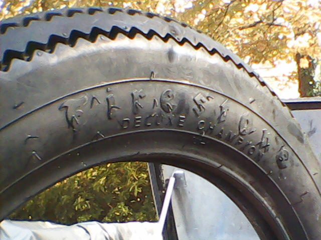

Tires and trim
Well,...I'm down to ordering all the detail goodies....found a great deal on Firestone 4 ply vintage tires and also got NOS peg rubbers, badges, NGK plug boots, latch knobs, etc. Pics below.

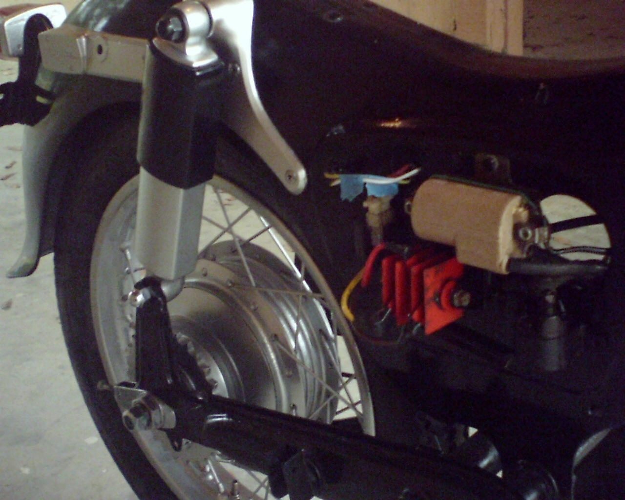

Update..Lights, camera, action
Lights, camera, action....got the wiring and wheels done. Everything works first try! This is starting to look like something and I'm pleased. Pics posted....
