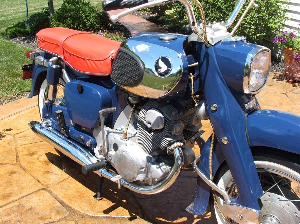

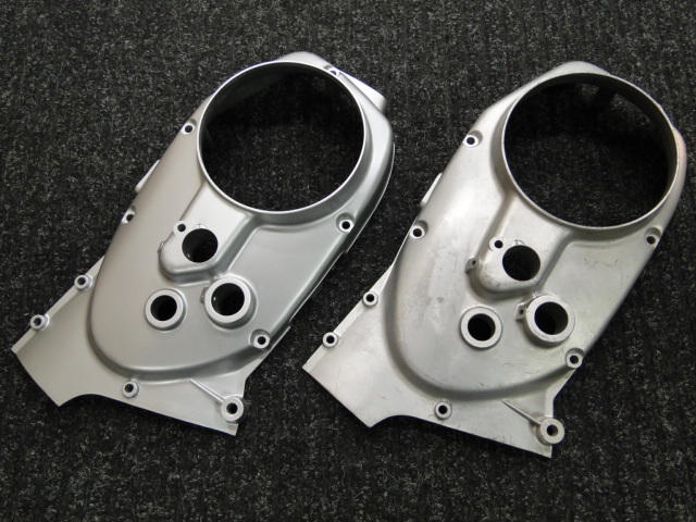

Here's my '66 in its original blue, probably faded a little... For the painted aluminum engine covers, carb covers, etc I swear by VHT SP127 Universal Aluminum. Its a good match and is fuel resistant after you bake it on. NOS cover on the left, Universal Aluminum on the left.
