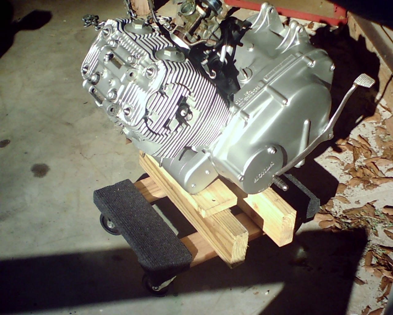

After wrestling my 305 engine in and out one time (only). I made the engine dolly pictured below, out of a Harbor Freight $11 movers dolly, two 2x4 pieces, and a 1x4 strip. It took 90 percent of the engine removal/install hassle out of a recent head gasket change. Otherwise these engines are heavy and awkward to handle.
Maybe this will help someone else. Just roll into place and tilt up and in.

Thanks! Post a pic of CL77 with engine out of frame and I'll give it a go.....That center bar must be a beast.

Re: Engine Dolly
I use the plastic tubes which fit inside a golf club bag.
I cut them to length then split them so they can be placed on the center and lower frame tubes. ........lm
