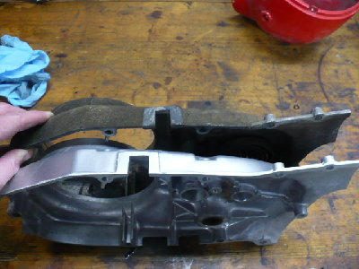

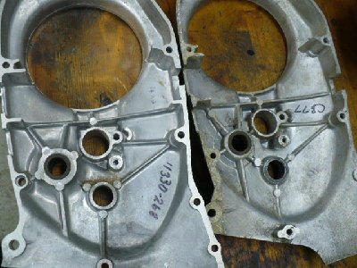

Depending on which cover you use you will need to use the matching clutch wire joint. The early joint 22875-268-000 is perpendicular to the cover and the later joint 22875-259-020 is a bit angled. The later covers in addition to beefing up the casting to prevent fractures also moved the location of the cable forward a little. I'll post pictures.
