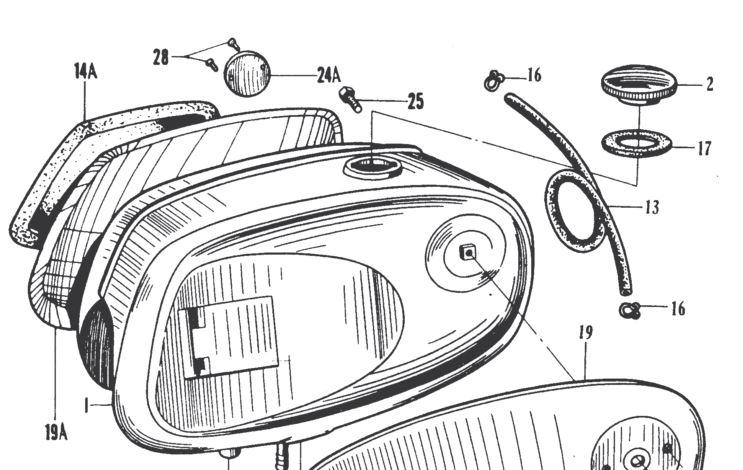

I am getting the tank ready and in the parts manual it shows a loop in the fuel tube that connects the two sides of the tank, number 13 in the diagram.
What's that about, if necessary should the loop be up, down or side ways ?

No loop, the drawing with a loop in it is Honda's way of depicting a length of hose(224 mm long). The right length hose should run pretty much straight across from one side to the other.
