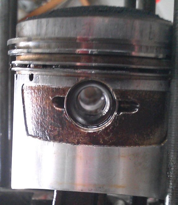

I recently did a tear down to replace the head gaskets on my '67 CA77, and found that my right piston is effectively fried. I am looking at doing a second over piston kit. I need to know what size the sleeves should be bored out to so there is enough room for ring and piston expansion. The following is the kit I'm looking to get;

The pistons you show are for the CB and will give a different compression ratio as the crown design is different from the CA.
Also - you need to check what caused the problem with the original piston. If you don't fix that you may have another expensive replacement to deal with.
Please send pics and we can help with the diagnosis...

The machinist that I took some pictures to told me it was from a low octane gas being burned in it. Something I also noticed are some slight differences in the pistons. Oil hole spacings are different on them, as well as the piston that is shot seems to have a taller crown (or at least from compression ring up seems to be higher). Also, the 'good' piston has cb77 stamped into it, as can be seen in the photo. The final killing factor on the right piston is that when I pulled the cylinders off of the rest of the engine, a piece of the piston on the inside around where the wrist pin clip is was broke off and fell out on my starter motor.
