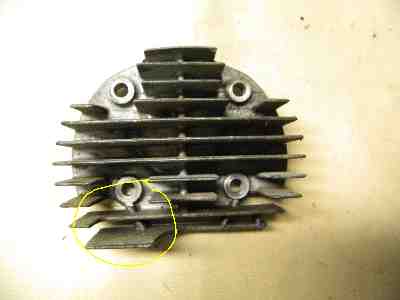

Sorry about that guys, I put the O-Rings on those knock pins, I used the fiche to figure out where they went.
BUT, I did just find the source of the leak. It's coming from the bottom left corner of the camshaft cover. I put a new gasket on there, cleaned up the surfaces well and tried reputting in the 4 screws that hold it in place, but they're pretty stripped out. That's making it leak LESS, but I think I need to go buy some hex heds to really torque that sucker down.
This is where the leak was/is.
