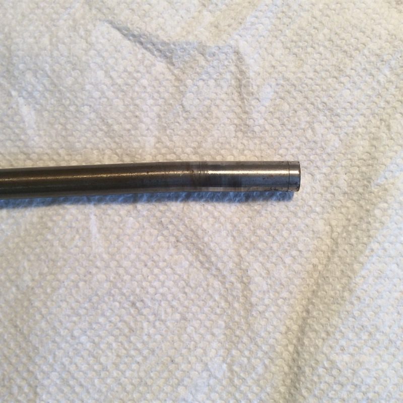

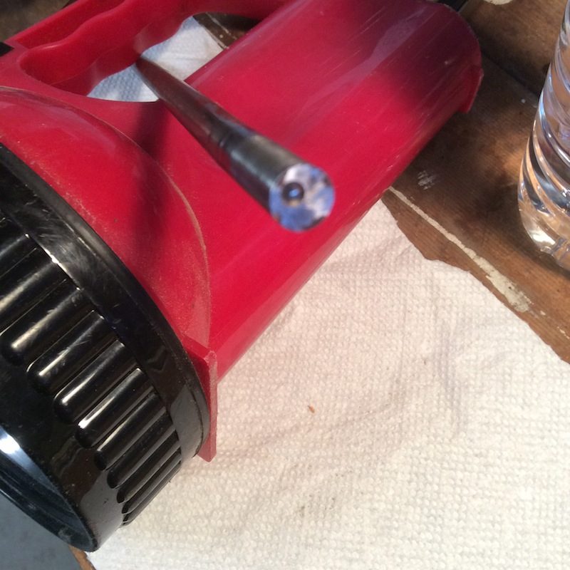

Messing about in my right case area today and noticed that the clutch actuator rod is bent, flattened a bit and scored on the portion inside the case. The detent for the ball bearing is also off center. Any idea how this happens? Before I buy a used replacement, is there any variation in early or late model rods that I should know about? Mine is approximately 9-11/16 inches long. The seal should also be replaced. Hopefully I can find one at the Honda dealer.
Post by G-Man » Sat Jan 31, 2015 3:40 pm
Maybe the drive chain came off and caught it......
