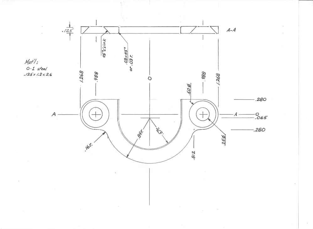

Honda 305 fixing plate dwg. Allows plate to be installed open side upward, without removing engine/splitting cases. 1/8"mild steel can also be used, but 0-1 is already ground flat, and better mat'l.

Dick Eastman wrote:Honda 305 fixing plate dwg. Allows plate to be installed open side upward, without removing engine/splitting cases. 1/8"mild steel can also be used, but 0-1 is already ground flat, and better mat'l.

If you make one of these, just make sure the plate remains flat. With the drum groove at .129", and the plate at .125", there is not much room for error. I gage-blocked my drum groove, and it may have had some wear, although it did not appear so. The plate can always be surface ground down less than .125, if need be. Also, the .03 ch or rad is important, as the drum groove diameter is 28mm [1.102"], with a small radius in the corners. The plate dims. clear this by .020"/side.
