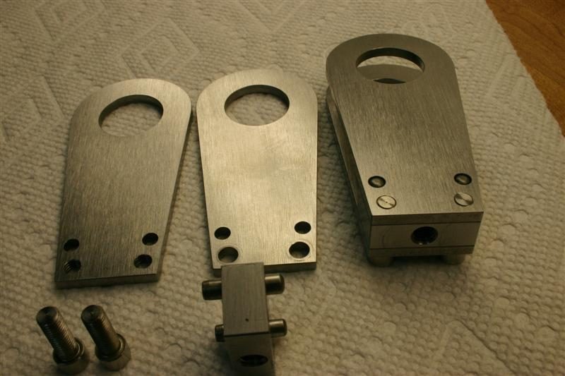

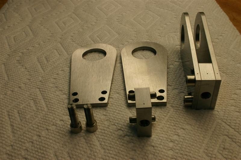

I never have liked the stock chain adjusters, and the 3 pairs on hand need a lot of work to look nice. I made some new ones that are 3 pc, and bolt/dowel together; I also added more "meat" to the 6mm thread block. The sides are made from tool steel, the axle holes are bored. I still need to plate them. The sides were stacked together and machined as one part.

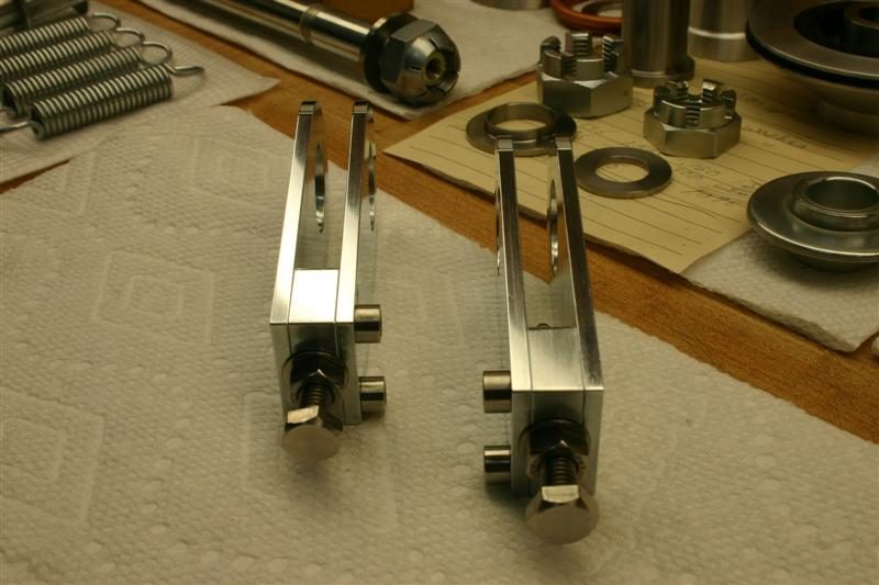

I plated them this morning, changed the machining dowels out for some S/S pins I turned up
