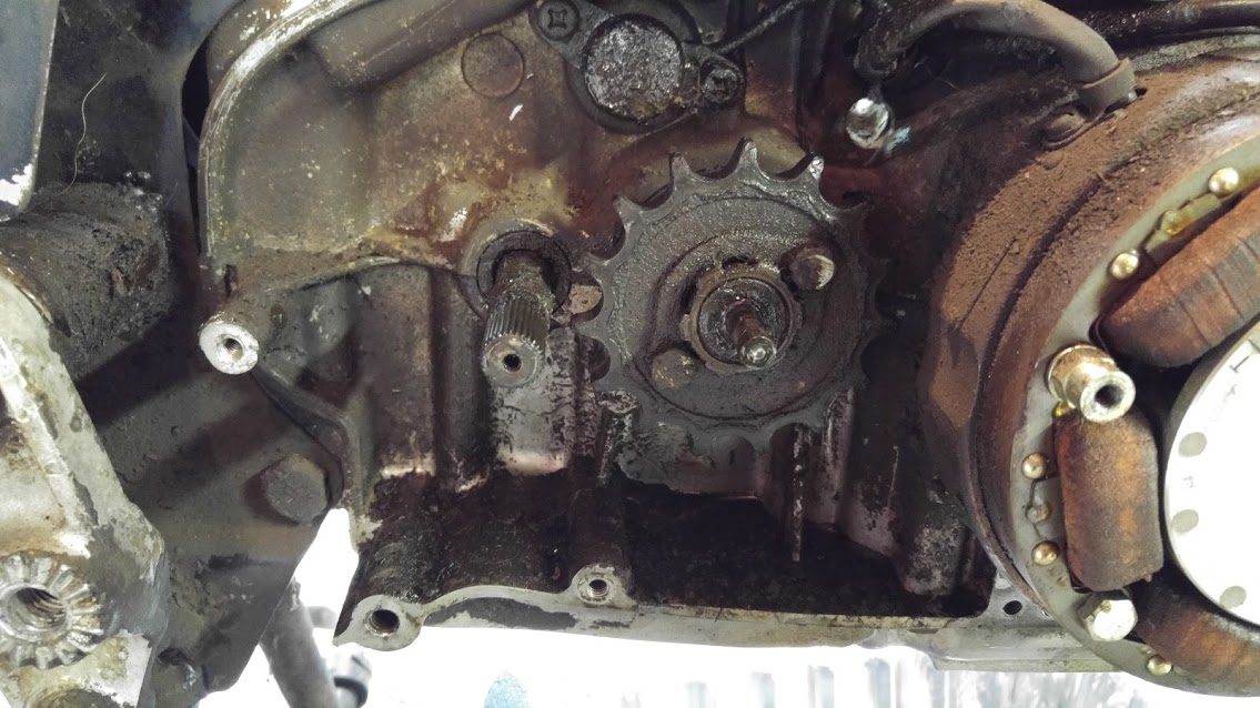

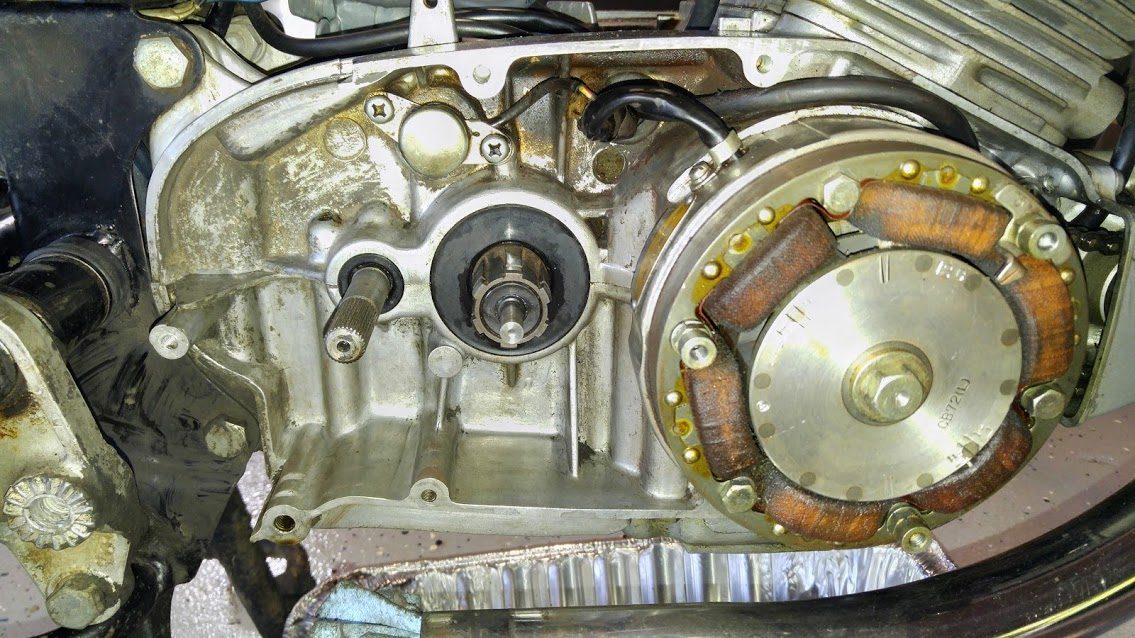

Hi all, I just purchased a 1966 CB77. and this is my first time working on a bike other than oil changes.
The guy who sold it to me gave me a new clutch cable.
So, I wanted to replace the clutch cable. When I opened the RH Crankcase, it was covered with oil and/or grease.
So, I was searching on this Forum to find out what grease to use...
Instead I found out many people have issues with clutch rod seal popping out???
Question 1, Which one is the clutch rod seal? the one behind sprocket? mine does not look like it popped out... can someone confirm?
how would I know if this mess was caused by the oil leak? i have already cleaned it all...
Question 2, so... what grease do I need and where do I apply? just inside the clutch adjuster ?
When I tool the RH crankcase cover off, my initial thought was that grease needed for the clutch adjuster and kick starter gear... Why can't i find the information about grease?

- before cleaning
- before.jpg (127.56 KiB) Viewed 3517 times
- after cleaning
- after.jpg (171.47 KiB) Viewed 3519 times
