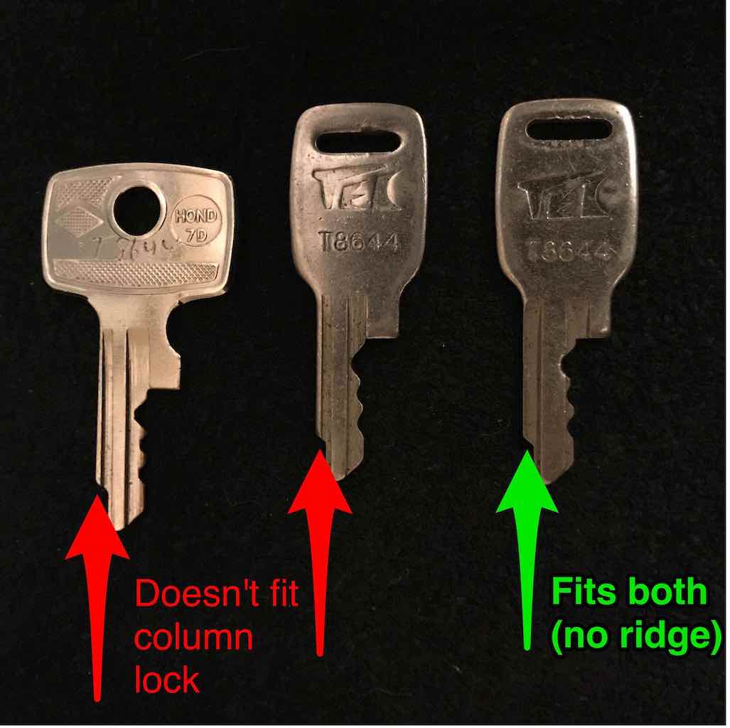

3030vision wrote:Just a quick update: I ordered 3 new keys on eBay (can't be too safe) and none of them work. At this point I'm not sure if they keys were cut incorrectly or if there's an issue with my switch (assuming the former for now). Currently looking to source some older keys...
The search continues :/

Post by 3030vision » Tue Sep 19, 2017 2:39 am
Alright, so I finally worked the three newly cut keys from eBay into the ignition. I couldn't get any of them to even partially enter the column lock, which was also marked T8644.
I ordered two old keys, and only one of them works in both locks. Closer inspection reveals why: The newly cut keys and one of the old keys has an extra ridge on the top of the key (see the photo).
I can't imagine why this bike would have shipped with two slightly varying keys, so I imagine I should try to track down keys without the ridge that will work in both locks.
Interested to hear thoughts, but also hope this helps with others having key problems.

Post by AlanW » Tue Sep 19, 2017 3:00 am
Well done for getting to the bottom of it. The keys that don't fit, could you take the ridge off very carefully with a Dremmel and use them as spares?

Post by 3030vision » Tue Sep 19, 2017 3:20 am
AlanW wrote:Well done for getting to the bottom of it. The keys that don't fit, could you take the ridge off very carefully with a Dremmel and use them as spares?
Al.
I figured I could file them down, but when I'm paying >$10/key, I don't feel like I should have to do that :)
