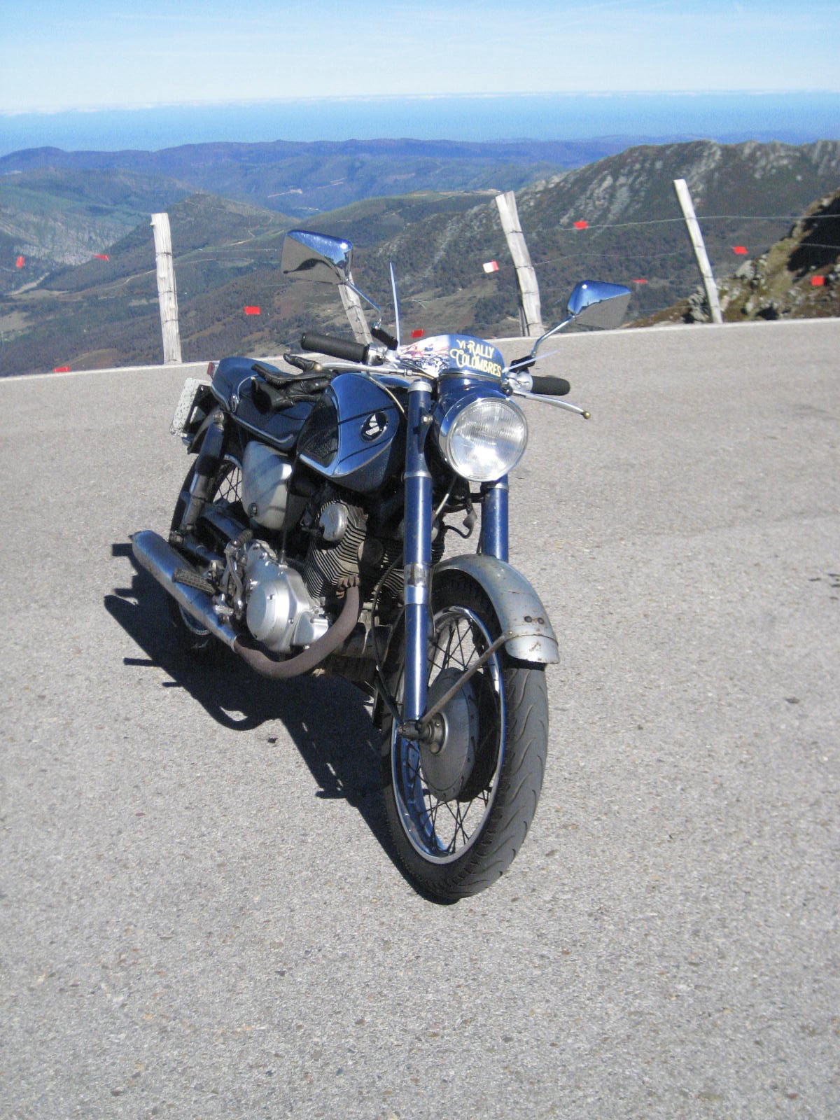

Aside, just done the Colombres Rally. Didn't pink or miss a beat with the altitude and climbing stuff. Unlike my former buddies (yes, we are enemies now) 650 BSA Spitfire. Talk about hot and bothered !
Will heaven be so good. I doubt it.
