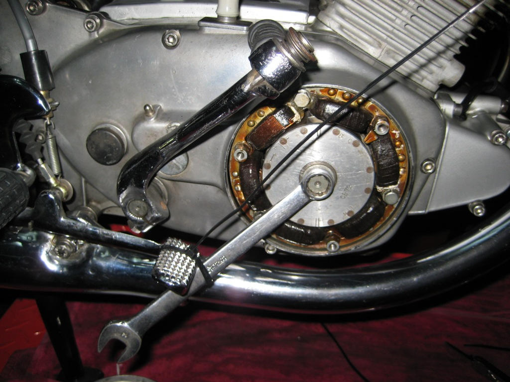

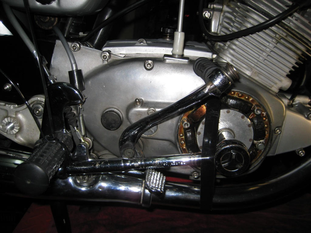

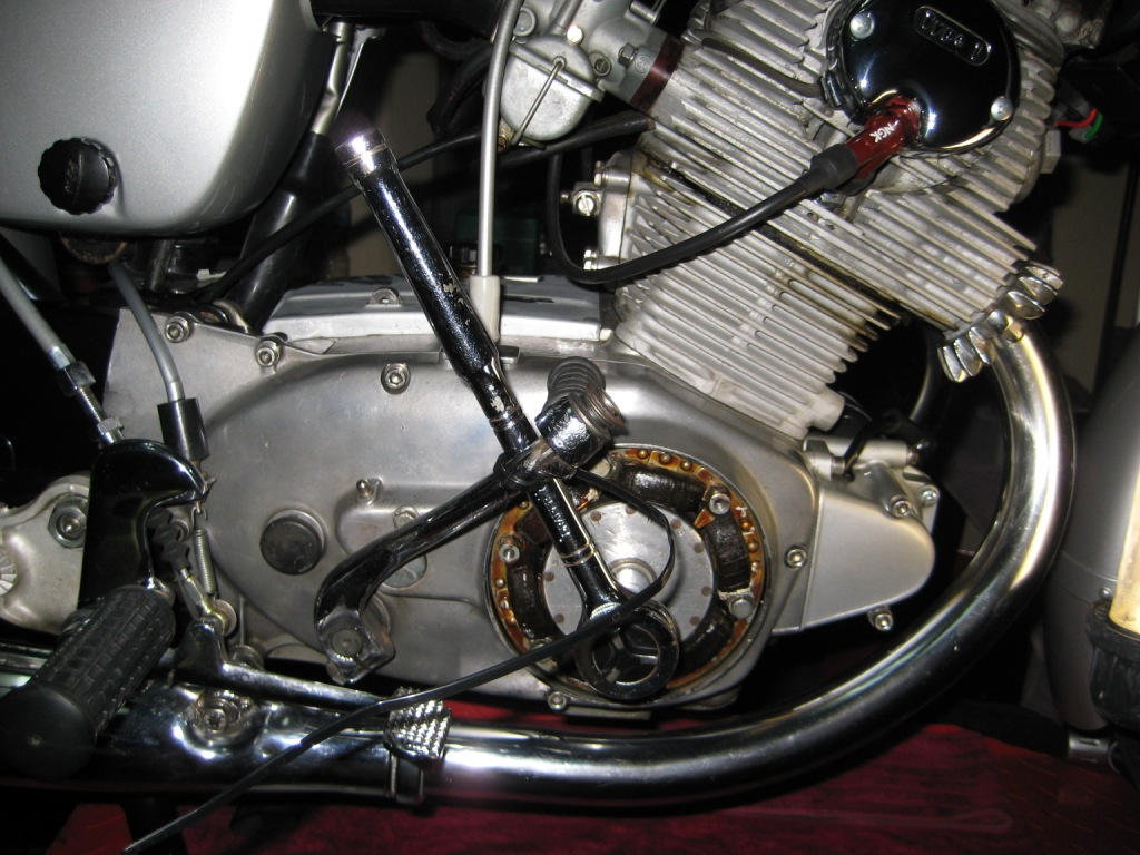

Ready to roll (off)
As I stated previously: many ways to skin a rabbit.
Images showing mine prepped for a "centrestand rolloff" to shock the rotor bolt loose.
Use top gear. One method should do it eventually. With only a (shorter) ⅜"-drive ratchet to hand, use two hoseclips to extend the length of the ratchet handle using a strong-bladed screwdriver.

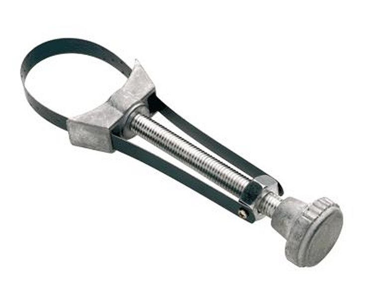

My advise would be : removing the kick starter side cover and the stator, and clamp the rotor with an oil filter clamp, so you add force only on the rotor, this has no effect on the crank in any way. Use penetrating oil a few hours before removing the rotor.
