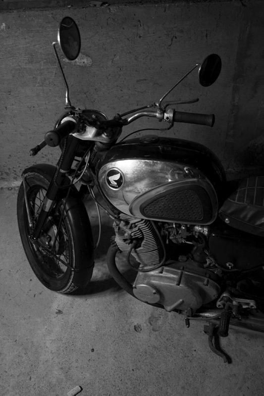

I gave the bike a very quick, light wash (with a toothbrush and a spray bottle of diluted cleaner/degreaser, but I ran out of time and couldn't do as thorough a job as I'd have liked.
I've resigned myself to eventually take apart the bike and completely clean everything off, but not quite yet. I bought naval jelly already, but I'm going to wait until money has changed hands before I do any more work. It really is a very pretty bike, cleaned up a little. I can't wait to see it when it's all restored and shiny and happy (and, most importantly, running well.)
Gas tank cleaning & pics coming soon.
Check out the pic!
More pics later as I do more to it.
