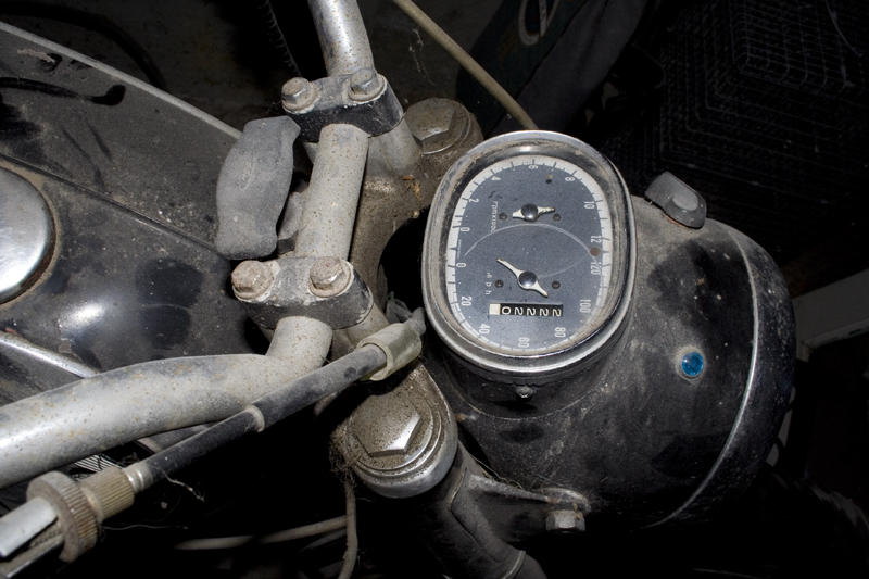

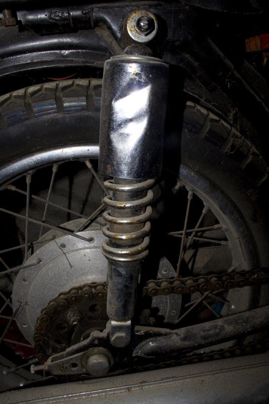

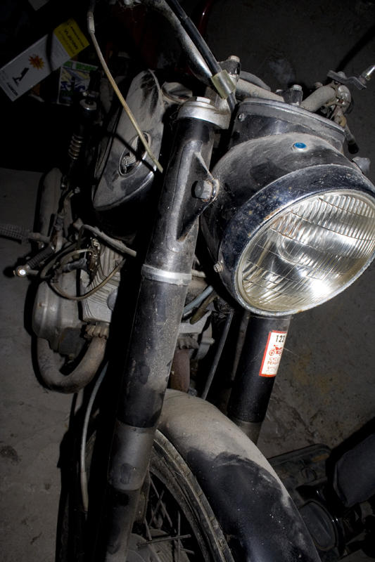

Quick points on the bike: Broken speedometer, wrong shocks, missing chain guard, looks like it would clean up pretty good though!

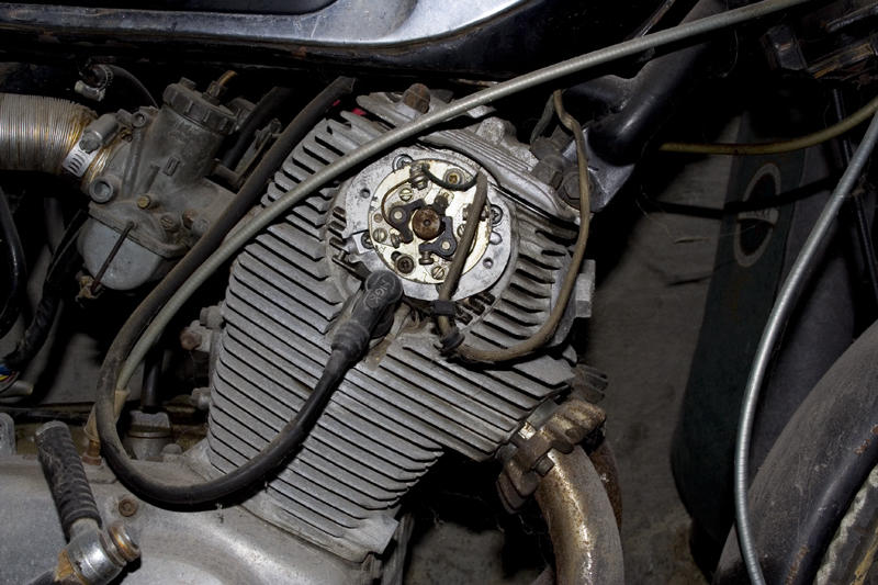

If it hasn't run in 8 years, the engine may be stuck. Try to turn it over using the kick start. If stuck, pour some oil into the cylinders through the spark plug holes, let it soak (days or weeks), remove the round dynamo cover on the lower right side of the engine, and use a large wrench on the dynamo bolt to try to break the engine loose, turning clockwise. Then use a compression tester to check compression in the cylinders. If compression is good on both sides, (160+ psi after several kicks, holding the throttle wide open) you might be able to avoid having to open up the engine. If not, the engine will need to be rebuilt, with new piston rings at a minimum. Good luck!

Even if there was no gas left in the system, you probably will want to rebuild the carbs, clean them out, check the floats for pinholes, replace the rubber parts, etc. You can get inexpensive Keyster rebuild kits on eBay, and just use the gaskets, etc from the kits. Don't use the jets from the kits because they aren't well calibrated. And you'll probably need to clean and rebuild the gas petcock. Rebuild kits for those also available on eBay.
As for the engine condition, just take of the round dynamo cover on the lower right side of the engine. You'll see the dynamo rotor with a bolt in the center. Put a box wrench on the bolt and try to rotate clockwise. If it won't move, then the engine is stuck, and you'll need to proceed with the "unsticking" efforts.

I removed the dynamo cover and put a wrench on the bolt - the engine is definitely not stuck. It kind of feels like I'm turning something over in there when I rotate it far enough clockwise, and it keeps rotating freely.

Nice that the engine is not stuck. You may get lucky and not have to rebuild the engine. A compression test will give you that answer. There's really nothing else that could be wrong with it that you can't fix with the right parts, time, and patience. Expect to spend around $500 in parts to get it in basic running condition, and take the plunge! You'll probably get hooked, like everyine else here! Worst case, if you lose interest or whatever, you can resell it on eBay and should be able to get your money back out if it.
