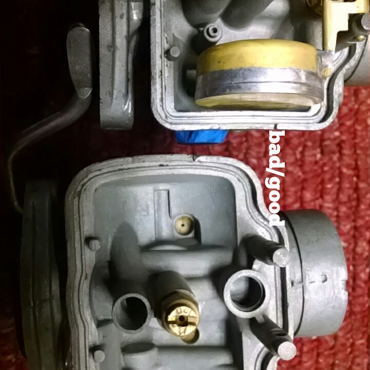

The one on the right is the carb that is on my 1965's

The carb on the right is an early "round bowl" carb. The one on the left is a later "square bowl" carb. Bowls are not interchangeable.
HT

G-Man made a statement that got me to thinking when he said that the early carbs had convex sides. learned from LM that these were referred to as round bowls, and I have been telling all of you that the ones I have were 1965's. That is what the titles say. After checking the carb on my white Dream and discovering that it was a square bowl instead of a round bowl I decided to check the frame numbers. It seems that the blue round bowl bike is actually a 1963. The white square bowl is a 1964.
Blue Dream-CA78-312783
CA77E -317810
White Dream-CA78-1006332
CA77E-1006246

By your numbers the white Dream s a 1965.
HT
