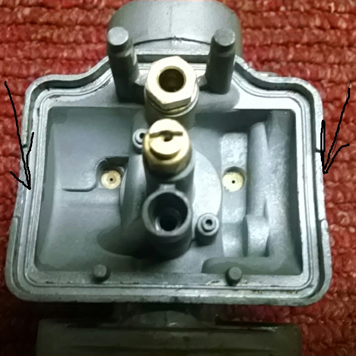

Hello G-Man, sorry it has taken me so long to respond. I had a lengthy reply ready to go and lost it because I wasn't logged in. I did get another carb body from ebay. A couple of hours cleaning it and even put a little clear coat on. It was missing the float bowl and other stuff. No big deal, I would transfer my parts to the ebay carb body. It was time to put the float bowl on and much to my disappointment my float bowl would not fit. The sides of the carb body where the bowl snaps in is slightly concave. Whereas my original carb body is slightly bulging on the sides parallel to the engine. I would not have expected the carb body to warp due to not having the float bowl in place. Have you had any experience like this? Here is another effort at replying. I could tell several stories of witnessing the aftermath of slides installed backwards. The slide in backwards usually creates a situation where the bike is difficult to start. The slide in backwards victim then resorts to having a buddy help "bump" start the motorcycle by placing it in 2nd or 3rd gear and pushing it fast as possible and then dumping the clutch. Persistence pays off and it will start but at full throttle in 2nd or 3rd is considerably faster than us human beings were meant to run and hold to handlebars. The excitement usually does not last long, although the consequences may last a life time. What I am about to say next is not for your benefit as you already know the things I will mention. The next few comments are for the benefit of readers that will come along in the future searching for answers and hopefully learning from our mistakes. It is much more difficult to put the slide in backwards than to install it correctly. The return spring stacks up because the slide is not in the slide bore as far as it should be. Twisting the throttle feels different because of the excess slack in the cable due to the slide not pulling the cable to its full length. Always verify that the slide is returning by listening for an audible "thunk" that is made when the slide bottoms out on the idle speed screw. In some cases one can visually verify that the slide is returning with a mirror and flashlight looking into the air intake side of the carb. The easiest way to check that your throttle cable has sufficient slack and not binding is to be at idle speed and turn the handlebars full lock both directions. There should not be any change in engine rpm. If there is then you have a little more work to do. You do not want to discover in a full lock turn that your motorcycle is going to accelerate on its own. If throttle response is erratic, sometimes hard to turn throttle or throttle not returning properly, one should be very afraid that the throttle cable is beginning to fray. Usually at the twist grip or at the carb.

Post by Creekwalker » Thu Dec 25, 2014 7:06 pm
Here is a picture showing what I attempted to describe when I talked about the float bowl area becoming concave.
Post by LOUD MOUSE » Thu Dec 25, 2014 9:29 pm
Not at all uncommon. .............lm
Creekwalker wrote:Here is a picture showing what I attempted to describe when I talked about the float bowl area becoming concave.
Post by G-Man » Fri Dec 26, 2014 3:12 am
Please send a pic of the carb you are comparing this with. Early carbs had convex sides to the float bowl.
E
