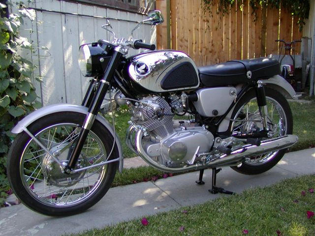

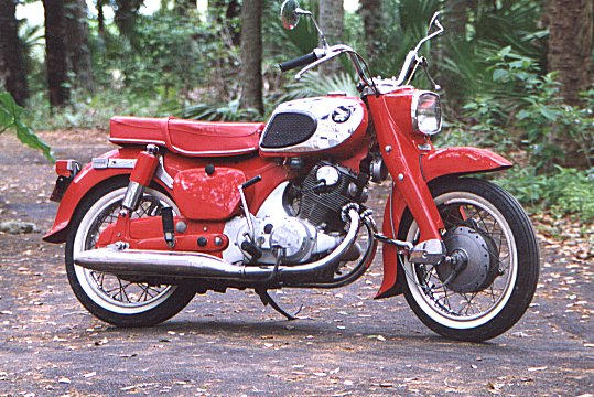

Here are some comparison photos. Other Forum Members might add further description...
.. MS
1962 CB77
1962 CB77
Early '60s CA72
Early '60s CA72

Dual carbs and points on the CB....180 degree crank on the CB verse the 360 on the CA,tire size,tach drive on the CB,plus the obvious in the pictures just to name a few.

As for what is different between the CA and CB, it would be easier to state what is the same. Light bulbs maybe, points maybe, cylinder and block maybe, but precious little else. carbs, head, wheels, suspension, frame bodywork, seat, most electrical, gear ratios, all different.
