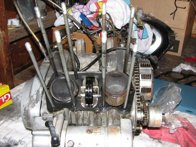

So far the work has gone well. Cleaning and rebuilding the carbs took a couple of evenings last week, and now I'm taking the motor apart, cleaning, inspecting, tagging and bagging each piece. Some PO has been into the engine before and clumsily at that, evidenced by stripped screws and dings and scrapes around the fasteners. I think he used an air impact wrench and was not an expert. Thanks to PB Blaster, a hand impact driver and application of a little heat, all the stuck screws came out, but they will all have to be replaced as will the acorn nuts.
Sunday I plugged all openings with wadded plastic wrap and gave the outside of the motor a thorough cleaning with citrus-based solvent and water. At least now it isn't a greasy, grimy lump on the bench.
Today I was able to get a wrench on the crankshaft bolt and turn the motor. Good news is that it moved very smoothly and easily. The cams and valve train appear to be in excellent condition and there is no rust inside at all. My priority now is to fully disassemble the engine and transmission, ensure all parts are in good condition, and rebuild. Then I'll see if it will run before taking on other areas of the bike.

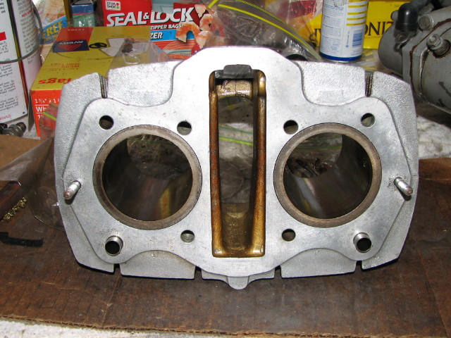

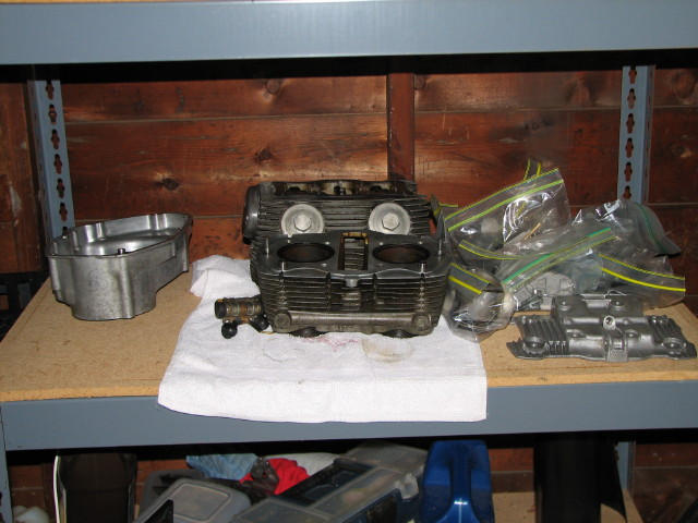

I've made a lot of progress on the motor. Carb cleaner and a brass brush work great cleaning the gasket gunk off the cast aluminum parts, as well as the ring of coke on the top edge of the cylinder liner. Note: the breather plate above the cylinder head is not the same aluminum and the brass brush does scratch it.
Have removed the head and cylinder. The good news is that the motor is smooth and well-oiled inside, the cylinder liners have not sunk, there is no movement when I try to wiggle the pistons up and down, and the head and base gaskets were not glued down and came up easily. I bet this engine would have run OK had I tried it before disassembly. The piston tops and chambers are coked up rather heavily, which appears hard to clean off. The rings and bores look perfect, but as the manual recommends new rings at 15K miles I'll put new ones in while it's apart anyway.
Some guys on the Sabre board use ultrasonic cleaners to clean carburetors - a few minutes in the solution and they come out as good as new. I wonder how they would work on engine parts like these pistons, and for cleaning the finned parts.
A note for the FAQ: have plenty of shelf space to store parts during disassembly. Parts in bags take up much more room than they do in the motor.

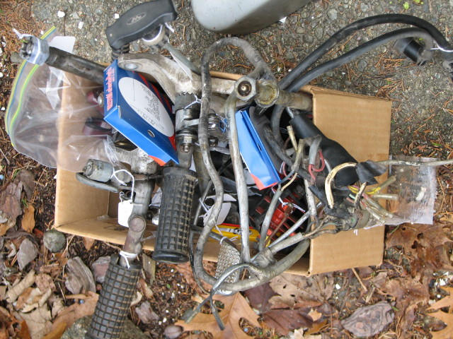

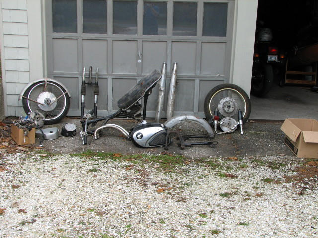

First pix: What I bought
This bike is a real basket case. The photos are in the reverse order of what I intended.
