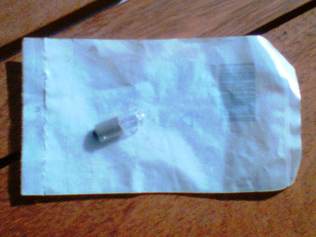

I've obtained and fitted a 12v/5w halogen front parking light. Now, a halogen lamp has a 50-70% whiter (colour temperature), brighter (candelas) light output, making it reasonably acceptable for daytime riding, even in sunlight. These are available from BMW dealerships, as they have been fitted for many years within some BMW interior (dome) and map-reading lights. Alternatively, they are available online from RS Components -- www.rswww.com -- , part# 370-3077, or from many yacht chandleries as a replacement part for Aqua Signal chart reading lights.
A slight mod to the wiring connections in the headlamp can also help with keeping the battery up: remove the front parking light bullet connector from the parking light circuit and plug it into the ignition circuit (black with white ring); this move brings the front parking light on with the ignition. There's really no need for the tail light to be on for daytime riding.
