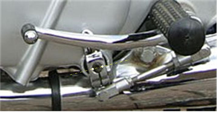

I'd be inclined to take up Ed's offer before he sells out; these shafts are as rare as unicorn poo. Get a shift pointer/lever too; if the splines are damaged on one component, then they'll sure as hell have transferred the damage to the other. If you don't replace both, you'll end up re-transferring the damage from the old lever to the new shift shaft!
As an interim measure:
- remove the left footrest ass'y & detach the shift pointer/lever from the linkage;
set the pointer on the damaged shaft, pointing towards 11 o'clock position and clamp up tight the lever on the shaft with no shim stock in place -- the linkage to the pedal, when at its rest position, should be +/- perpendicular to the pointer's bisector and parallel with the pinch bolt;
drill 2 x 3.5mm holes, diametrically opposite one another and in line with the pinch bolt's parallel, into the mating circumference between the lever and the shaft to a depth of 12mm and no more (or you could end up damaging the seal);
tap these drillings with an M4 thread and install 2 x M4X10mm machine screws -- Allen-head grub screws work best, as they're generally hardened.
