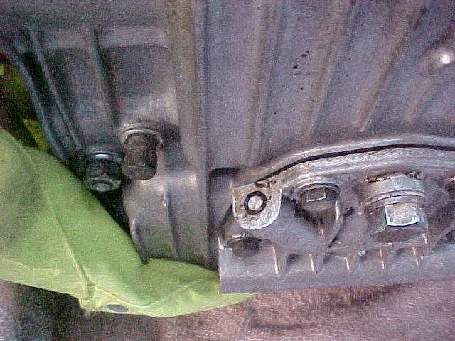

Bolting case halves together on a CL77 and the books call for a special nut and sealing washer on one of the 6mm studs next to the oil pump outlet. Anybody have a pic of where this actually goes and what it looks like and if a standard nut with a shoulder and a sealing washer wouldn't work as well.

The nut is that tall one with the closed end and the washer is aluminum. ...........lm

Thanks guys. I can make one now.
What were they thinking? Just wanted to make a nut with a flat bottom to take a washer and that is what they came up with?

It seals the channel where all the oil from the pump heads to the engine parts which need it. ..........lm

sealing nut
I love those little Asian engineers. They think of everything!!!!
