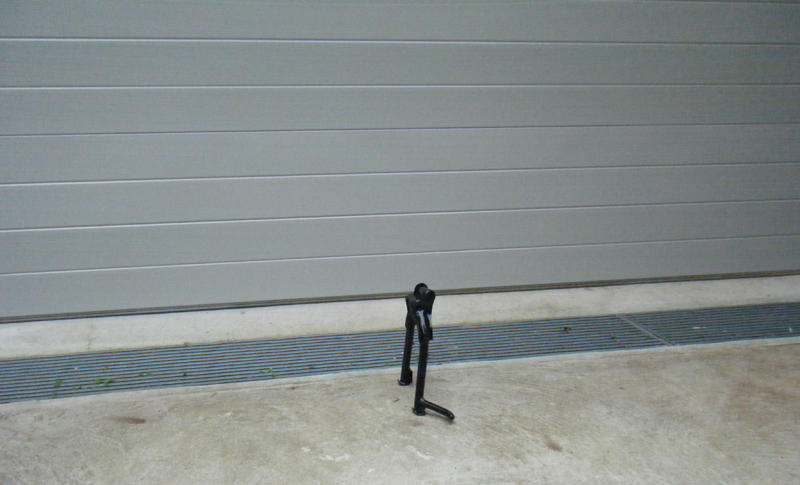

Startered the resto already. Have completely pulled it down and already have had the frame blasted and primed, along with the center stand and the swingarm. Only $99 for the lot. Will be sparying them black this weekend.

The completed Center Stand.

Smart of you to just tear the whole thing down. My mistake was thinking I'd only do a few things here and there, before essentially tearing the whole thing down. That photo of the center stand all alone reminds me of the "invisible LOLcats". Look forward to seeing the updates.
