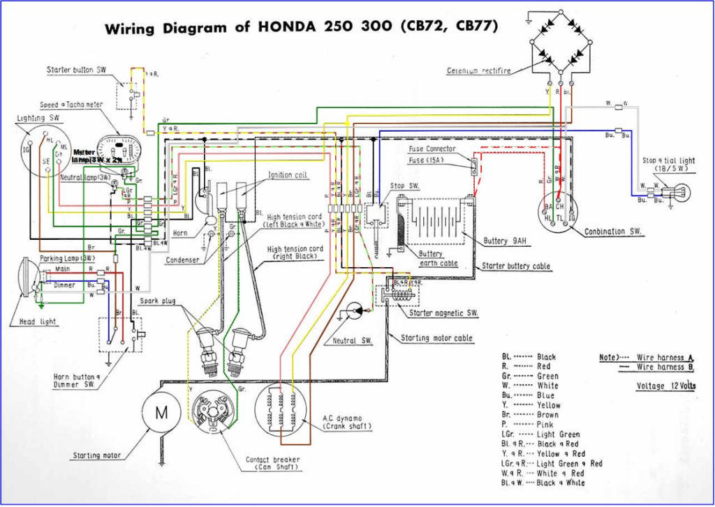

My loom (CB72 1964) is a bit hacked about around the battery area. It's mostly intact except I have a black/white wire from the rectifier going to what I think is the earth battery terminal and I have a thick (starter solenoid thickness) wire attached to it which looks like it should be attached to an engine bolt - is this correct? The parts manual isn't 100% clear but it looks like that may be the case.

buttery earth cable
My "buttery earth cable" (see wiring diagram) grounds to engine bolt. (62 cb77). Maybe your cable's a little short?
Great job on the coloured wiring diagram by the way, a real e3steve classic. Thanks, Lee

Thanks Lee, on both counts! The colour sure makes it easier to follow.
My grounding cable certainly looks OE, with the flag-type lugs at each end, but my CB's a bit of a mutt, so I'm not sure which parts are '61, '64, other years and AM Honda.

My ground cable fits the engine bolt, so that's where it's gone. The Bk/w wire runs to the rectifier though and was definitely bodged to the earth connector on the battery. I'll have another look to see tonight and maybe post a pic.
edit: Here's the pic - is this an original rectifier? Looks a bit like one to me, the bk/w cable at the bottom of the pic was connected to the earth connector on the battery.

No way, Pedro! That's AM.
The wires are added, also. That black/white is, in fact, white/black (main colour/tracer). The bk/gn to the fuseholder is a tack-on too.
If it was mine, I'd be partly rewiring with the correct colours. You need short lengths of 2.5mm²: green for the rec ground, red for the fuse holder. Let me know if you need more help.
