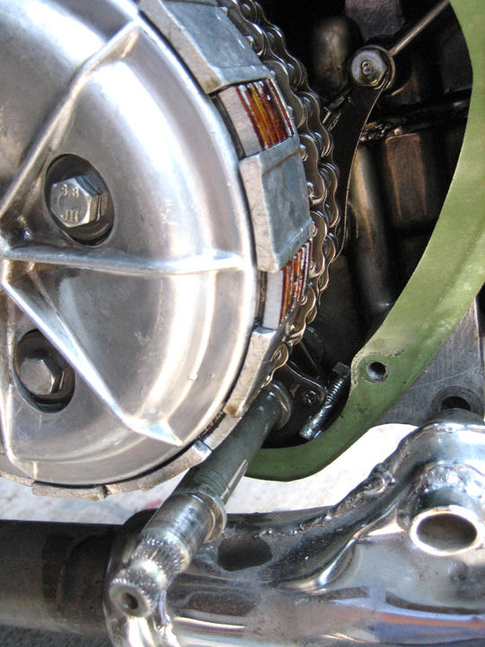

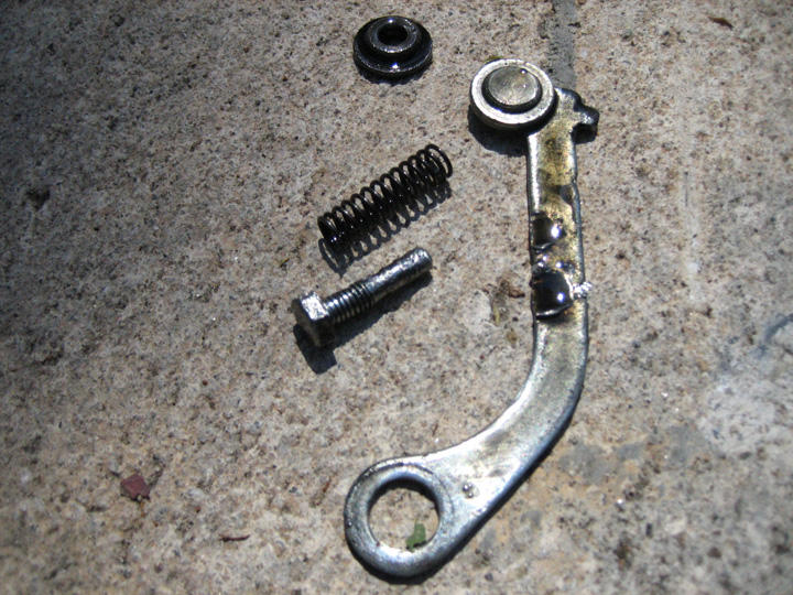

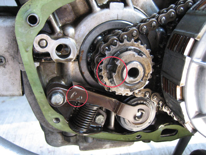

Pulled the cover.
Not a pretty sight.
I'm surprised I was even able to use first and neutral! Tough little bike.
What do you think happened? Did the bolt work itself loose?
It appears I need to replace that rotten bolt and perhaps get a new shift drum stopper. Am I going to have to drop the motor to do this?

REPLACE THE BAD PARTS AND NOT TO WORRY ABOUT THE BUR ON THE CRANK NUT.
YOU WILL NEED TO PULL THE CLUTCH/CRANK NUT AND OTHER PARTS ON THE CRANK TO INSTALL THE DAMAGED SHIFT PARTS. ..............lm
