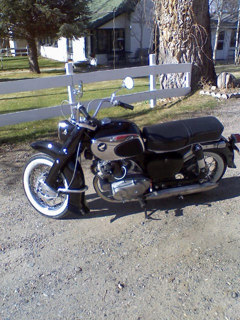

I've got my 63 305 dream back together after replacing tranny, rings, new paint. Frequently it blows the fuse. I'll get it started and all seems fine then nothing. I probably need to find a short somewhere but I wondered if perhaps this is a common problem?

You may just have a loose connection somewhere in your wiring harness. Go over all of your male -female connections as well as all others. If a connection is loose it will create heat and eventually blow a fuse. If you have a dead short it will usually blow a fuse instantly.

Thanks for that tip I will recheck them. Some of those old bullet connectors can be tough. I installed a new wire harness from Apexcycle which came with a 10 amp fuse. Later I thought to look at my parts book which listed a 15 amp. Which or what is correct? New handle bars from Apex should arrive any day and I will then be pulling and re-threading the wires that run inside the bars as well.

For testing situations such as this, attach a pair of croc-clip wires to the hi-beam (60 Watt) filament of an H4 headlight bulb in place of the fuse during test procedures (be sure to employ a 5-amp charger, a battery tender or, at least, jump from a car batt to support the consumption if a procedure takes longer than 10 mins or so). The lamp will act as a current-limiter, burning at full brightness whilst the short circuit is present; it will reduce in brightness significantly while less demanding consumers ~ ignition system, neutral light, parking lights, etc. ~ are being fed. You can then work your way through the connections until the test lamp goes dim, thus pinpointing the source of the short.
Remove the tank so that you can work your way along the harness, flexing and jiggling to see if there's intermittency or chafing.

Thanks so much for this tip. I'll dig out an old Harley headlight. I suspect that the intermittant short is in the handlebars as this first occured when I touched the horn button. Now it just happens when it happens. The wiring harness is new but that doesn't mean the connections are all tight as mentioned above. I've got some work to do.
