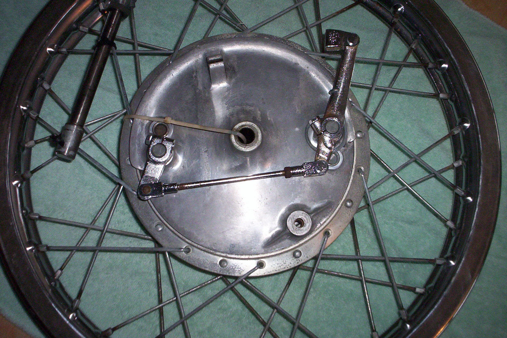

Post by gramey7 » Fri Jun 05, 2009 9:57 am
The attached photo is of a CL77 wheel but the following expanation still apllies: the spokes are installed alternatively in the hub from the inside (use the 45 degree spokes) and the outside (use the 90 degree spokes. The outside spokes in the photos are the ones you can see the head. Hope this helps

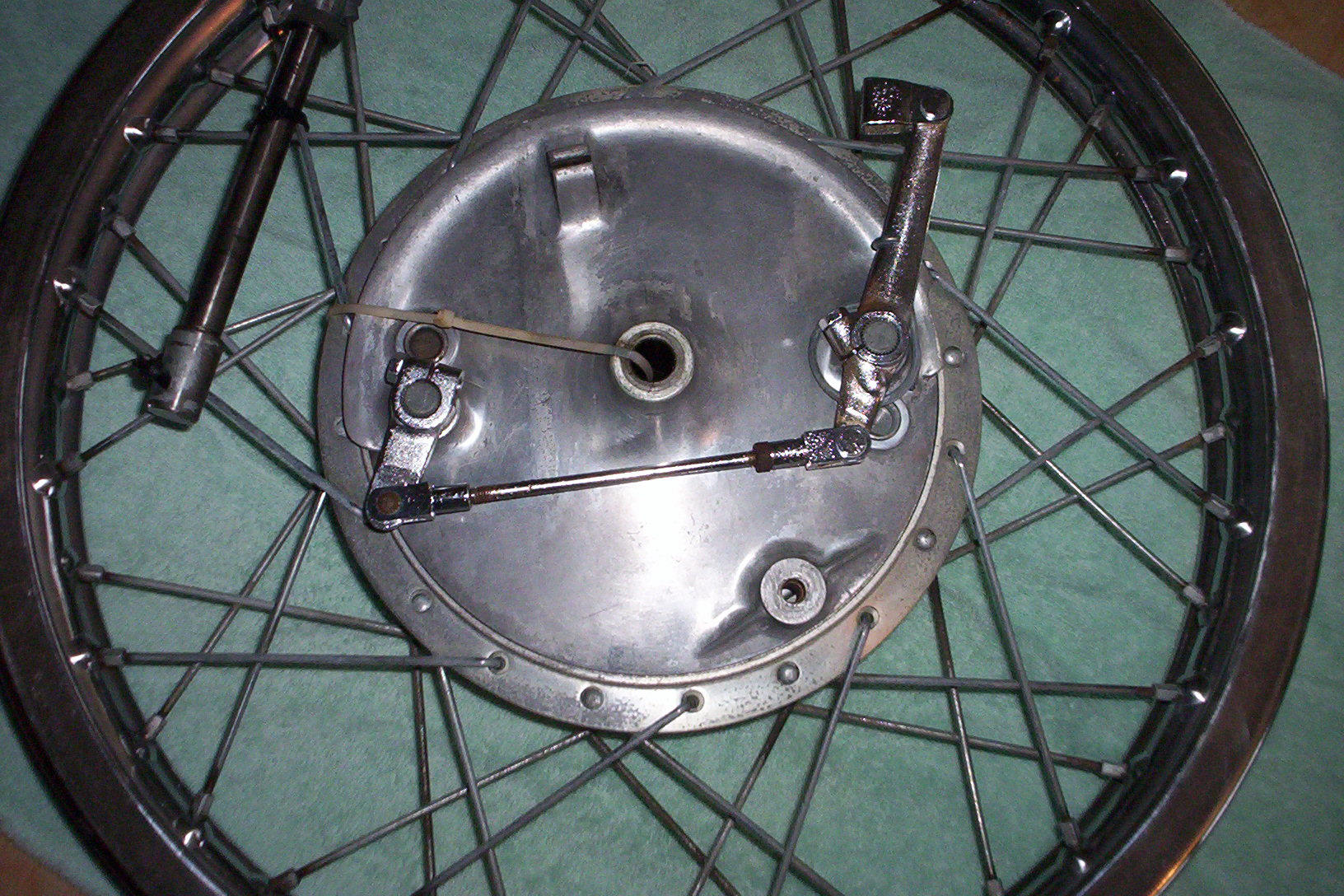

Post by Spargett » Mon Jun 08, 2009 2:51 am
Phase 1 (lace each side - 45° spokes going under)
Phase 2 (lace opposite side - 90° spokes going over - Drop spokes in from above)
Phase 2 - Laced
Phase 3 (Flip wheel over and drop 45° spokes in just as done in phase 2)
Voilà - I think the main thing overlooked in instructions is the ORDER in which the spokes are dropped in and how. I found this video to be a great help in that respect.
