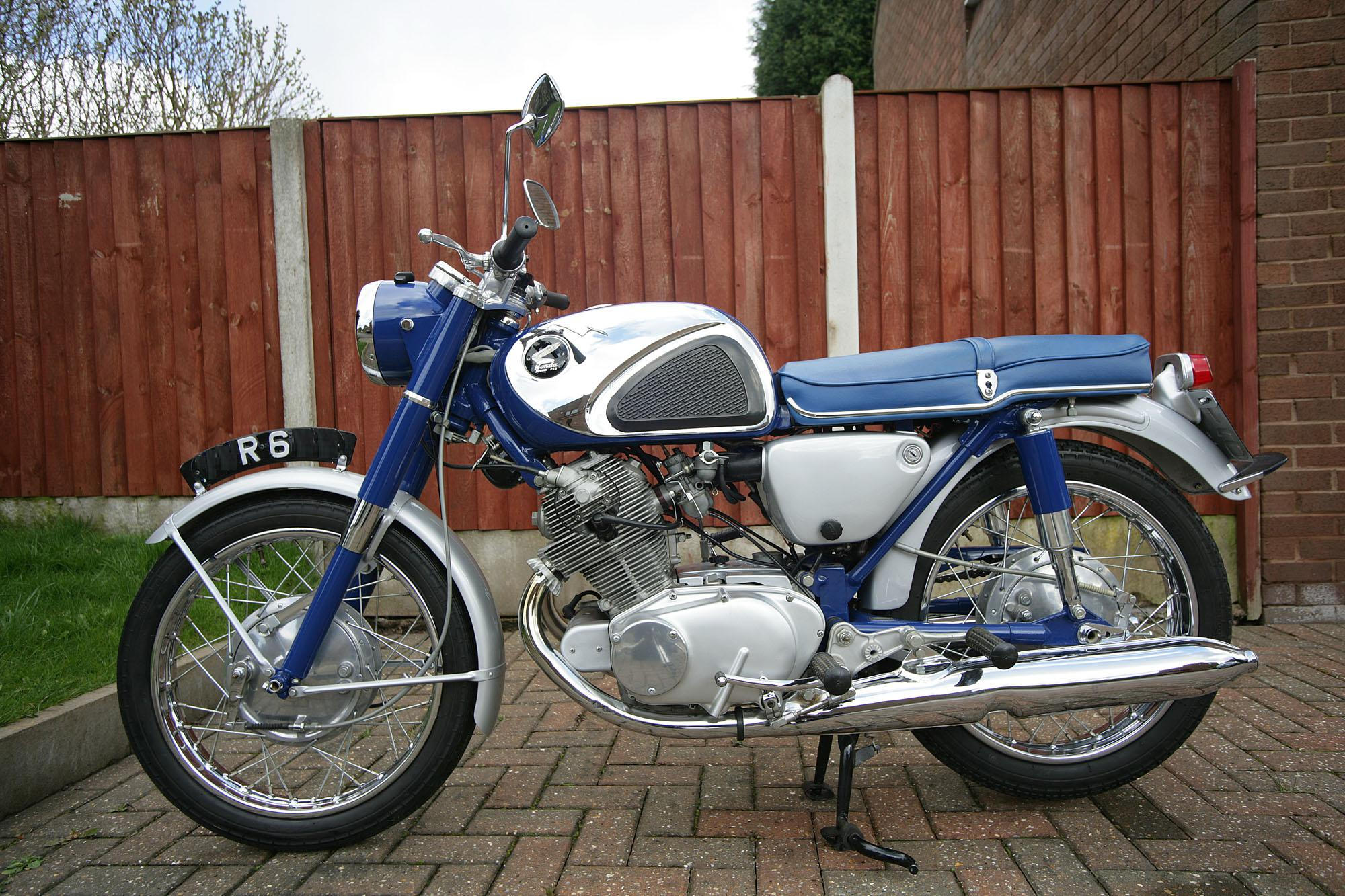

Post by e3steve » Sun May 23, 2010 5:00 am
All '61 model-year had SLS front brake.

Post by Paul Strassmaier » Wed May 26, 2010 12:52 pm
I'd have to dig out my paper work to see my serial number, but even my early 61 cb72 has a dls. It's early enough to have the black cables, short seat, and the aluminum shock covers and front fender, but not early enough for the sls. It must have only come on the very earliest models...
